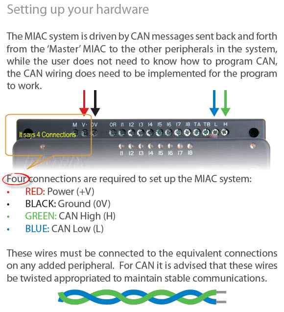

I have been looking through the MIAC manual and it says that I require 4 wires as per my enclosed diagram, on my setup I have a link in the TA & TB connections, the Can bus Hi & Low in the L & H connections then I have a link in the M & +v connections, but I have nothing in the 0v connection, is this right ?
Acestu
Acestu

- Enamul
- Posts: 1772
- Joined: Mon Mar 05, 2012 11:34 pm
- Location: Nottingham, UK
- Has thanked: 271 times
- Been thanked: 814 times
Re: RTC for MIAC(Part two)
I haven't told you anything about M& +V link. We don't need M pin at all. +V can be used or you can leave it depending on you. +V can be used as power supply for slave. MIAC datasheet is showing that..but you can use separate power supply for slave if you have or you can use +V. But you have to connect 0V pin of MIAC to GND of slave to have common ground. So for our case we can use 3 or 4 not necessary it must be 4.then I have a link in the M & +v connections, but I have nothing in the 0v connection, is this right ?
- acestu
- Posts: 1720
- Joined: Thu Dec 01, 2011 9:36 pm
- Location: Macclesfield UK
- Has thanked: 783 times
- Been thanked: 223 times
Hi Enamul,
Can I just clarify what is meant by "So for our case we can use 3 or 4 not necessary it must be 4." please, if you mean it must be 4 wires, could you please show me how to connect to my breadboard

Sorry for confusing you again. Can you please tell me where you running your slave PIC and RTC module from..I mean where it gets power from? If it's getting it's power from MIAC +V terminal in that case you will need 4 connections to slave. 2 are L& H, 1 is common GND (0V) and other is +V for slave +ve supply.
But if you are using separate power supply for Slave and RTC module you don't need +V connection of MIAC. You can simply ignore that. You need only L, H and 0V.

Hi Enamul,
My Slave on the breadboard has its own +5v power supply that plugs into mains, and I am powering the MIAC from a mains PSU, so I think from what you are saying is
I only need to connect the Can Bus H & L , and connect the 0v on the MIAC to the neg rail on my breadboard
thanks
Acestu

Absolutely right.I only need to connect the Can Bus H & L , and connect the 0v on the MIAC to the neg rail on my breadboard
