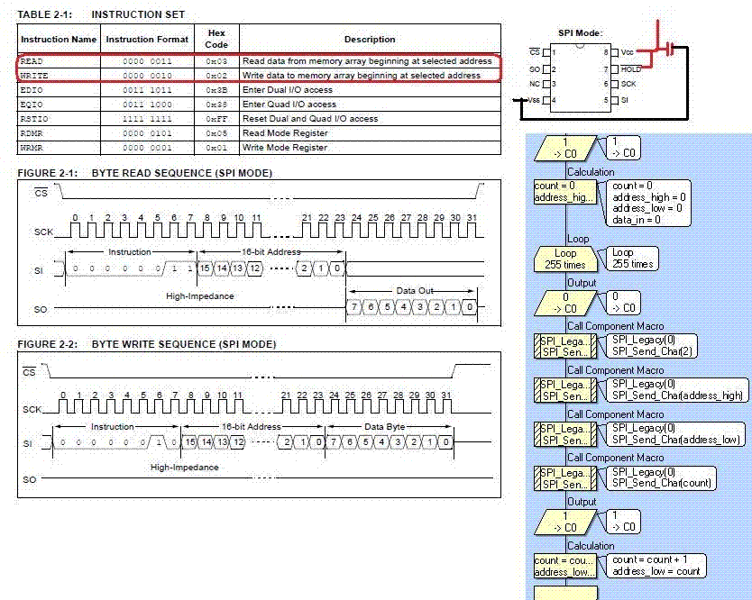

picked up some new chips for communication projects, the one of current discussion is this one http://www.digikey.com/scripts/DkSearch ... 16&cur=USD
this chip is easy to use, since im using a 16f1939 with 32k of memory i thought it would be funny if i also have external spi of about the same memory sram and eeprom, seems like overkill but you never know :lol: note: i only use this chip in byte mode
since its a 512kb chip, thats 65536 extra bytes of ram, thats addressed 0-65535 but broken down into two bytes
- first thing is initialize spi with settings in simi box
- command C0=1 which is slave select high
- write to the mode register for byte mode( C0=0, spi_write(1), spi_write(0), C0=1)
- can read the mode register back with (C0=0, spi_write(5), spi_read(), C0=1)
- then to write suppose we want to write a 1028 to address 500-501 we could do this with 6 variables to keep it simple to see,
to break the 16 bit (unsigned int) data and address variables down into two 8 bit variables, we need two extra variables for each
       address=500
       data=1028
       address_low = address & 0xff
       address_high = (address >> 8) & 0xff
       data_low = data & 0xff
       data_high = (data >> 8) & 0xff
- now a write can be done,(in sudo code):
loop_counter=0//byte variable
looped two times
C0=0
spi_write(2)//write to ram command
spi_write(address_high)
spi_write(address_low)
if(loop_counter=1){
spi_write(data_low)
else
spi_write(data_high)
address=address+1
C0=1
loop_counter=loop_counter+1
- to read data back the inverse is done
address=500
looped two times
C0=0
spi_write(3)//read from ram command
if(loop_counter=1){
spi_read(data_low)
else
spi_read(data_high)
address=address+1
C0=1
data=data_low+(data_high<<8)
here is chip operation
wanted to add: fcf writes 0-32766 which is 16 bit numbers taking up two ram locations per number, so total ram locations used is 32767*2 bytes
SPI SRAM BYTE.fcf
saves 0-32767 & recalls 0-32767
(22.77 KiB) Downloaded 508 times

previous example was byte read and write mode, in this example we can fill all the ram locations at once with out delays with one address, then read them all back with one address, key to this is in sequel mode it autoadvances from the start address!
to enable sequel operation (C0=0, spi_write(1), spi_write(64),C0=1)
im using same fcf example only modified for different mode
for this mode just give it a start address (C0=0, spi_write(2), spi_write(0), spi_write(0)
then you can send 0-65535 bytes one after the other without delays, after the last byte sent make C0=1
to read them all back its the same way but inverse
(C0=0, spi_Write(3), spi_write(0), spi_write(0),
then send as many spi_read() as you want, when done end with C0=1
if only eeprom were like this instead of having to use page write :lol:
SPI SRAM SEQUEL.fcf
(22.23 KiB) Downloaded 521 times
