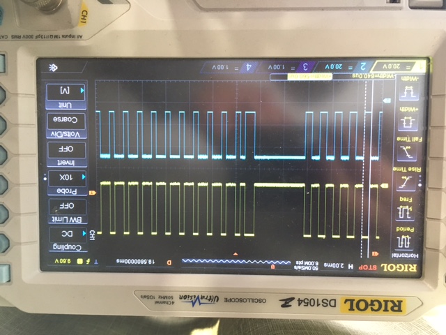

hello forum guys... okay so I have attached a small FC7 created flowchart.. which sposed to help in creating some pulses, via the PWM logic in the chip. I using a 16F1936, with internal frequency of 16 mHz. So then the program creates first a series of 12 pulses.. with 50% duty cycle. The period of the pulses is.. 1200 usec. So at 50% .. a MARK pulse is at 600 usec width, whilst the SPACE pulse is at 600 usec width. After this is complete.. the program carries on with the next stage.. after a 4 ms delay. The next stage, has to create a 32 bit pulse train, where the MARK/SPACE ratio of the pulses varies from say 400 usec = MARK pulse, to 800 usec = SPACE pulse. So the program does loop and create the 32 pulses.. but when the pulses are generated, there is a macro called, which reads a 'digit' from an array file..(compiled into the C-code)..LUT..(LookUp Table).. So as the macro reads the array.. the values are 'index'ed off .. with index variable incrementing, so that the variable 'digit' has the value of the 'index'ed read from the LUT array.. So the first 'digit' should be.. a '0' at 'index' position 0.. and then the second, third, fourth, and fifth 'digit' should be '1' values with incrementing 'index' value, accordingly.. So this happens.. okay..(or is it.??).. When we get to the 6th place in the array.. (load the FC7 flowcode file.. go and look at the array in the LUT.. component...), we should be having a '0' in the 'digit' variable.. which sposed to be sorted out to be a wide pulse.. so the PWM1 component.. will then output a pulse of 800 usec width.. BUT IT's NOT..!
So anyone maybe interested.. in helping me find my SIMPLY STUPID fault... in the FC7 file..
Okay forum guys... anyone may help.. please... thanks.. folks..
If you look at the photo.. of the waveforms.. you can clearly see the different widths of the pulses... The first 12 pulses are there on the left side.. not all shown.. but the 32 bit pulse train sposed to be varying in widths.. of each pulse depending on the value of either 0, or 1 read from the array file.. of the LUT..
Thanks very much..
