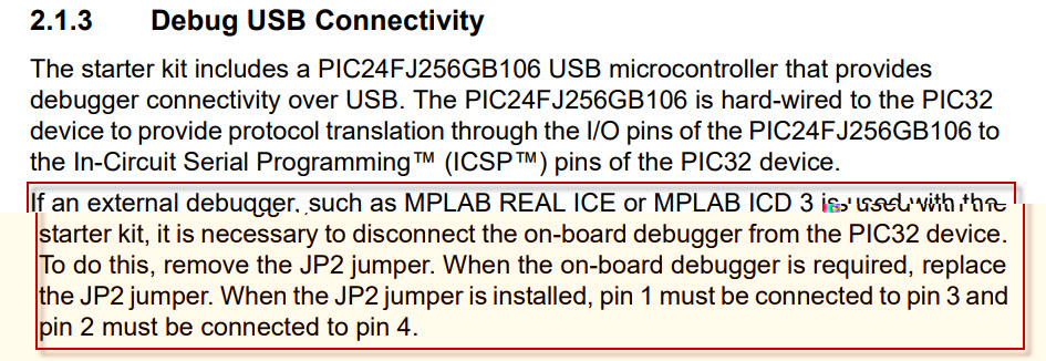

Re: Getting PIC32MZ connected
Just take note of this jumper setting when using your PICKIT3
- 1.jpg (196.79 KiB) Viewed 16891 times

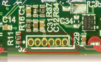

Hi Igor,
I think the J7 connector is the right one, if you use PICKIT3.
Best Regards,
Lagoda
Best Regards,
Lagoda
- (224.33 KiB) Downloaded 3692 times
Hi looking at the manual closer now you are correct it is J7
Regards QMESAR
