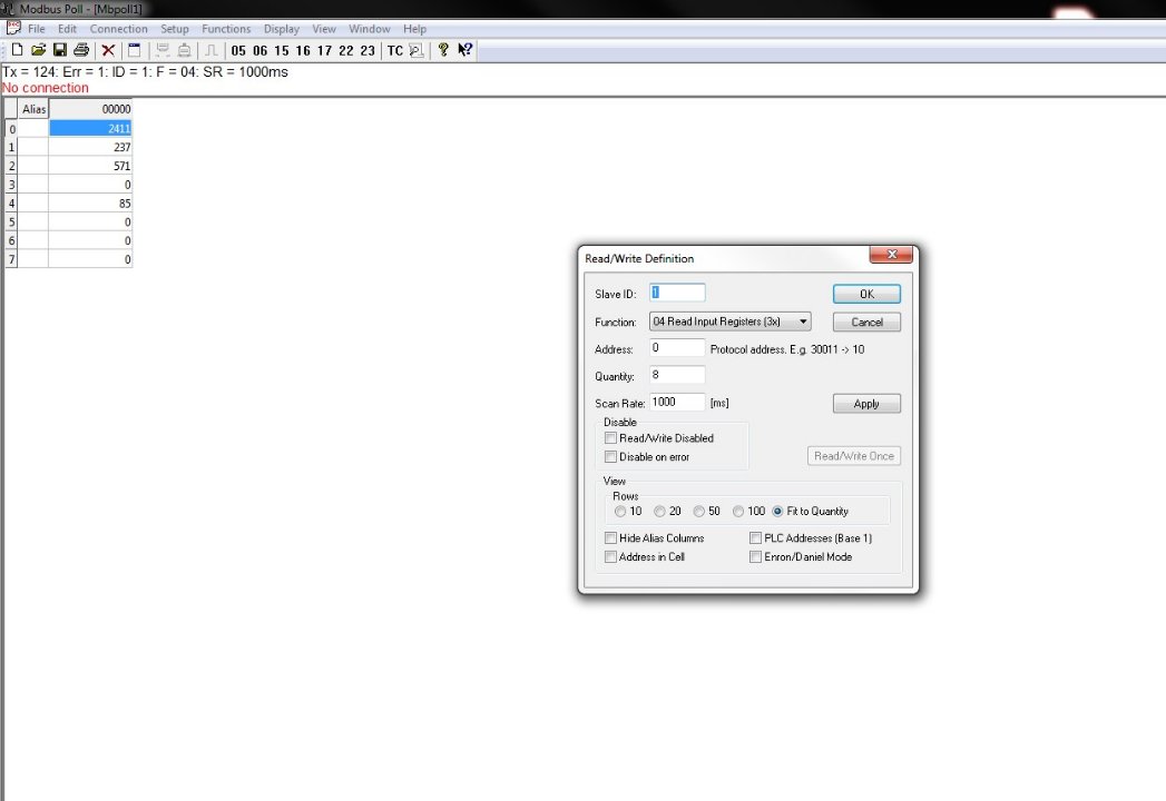

Using Modbus Poll software i managed to communicate with the slave device and get the expected data.(see pictures)
The only options in flowcode for getting data through UART is to receive as string or receive as char.
If i use the option "receive as string" what would be the next step to convert those data to a format that i will be able to show on LCD?
