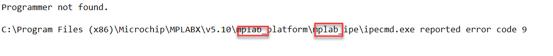

Loading the flowcode file into my 16LF1847 microchip shows an error "Programmer not found" with error code 3 or 9.
Some idea what the reasons can be?

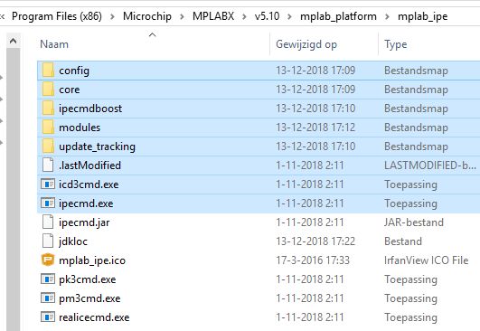

My location is still:
C:\Program Files (x86)\Microchip\MPLABX\v5.10\mplab_platform\mplab_ipe\ipecmd.exe
And the problems are still left.

Probably to due an newer version of MPLAB, the directory is now: Kind regards
Jan

I tried it first on my Laptop (see messages above) and now on my PC. A different error message, but with the same result. On this moment I will stop using the PICkit 3. All of you, thanks for helping
Kind regards
Jan
