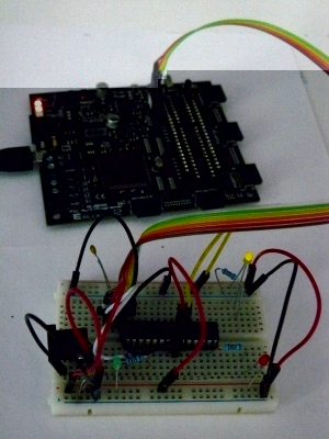

Becasue the problem can also be a hardware problem, I made a new set up by means of a breadboard, see picture. But the same results, no green and/or red LED's are going on. I changed the flowcode that all A-ports should be going on and all C-ports. Nothing happens.
16LF18857 breadboard.jpg (129.24 KiB) Viewed 5381 times
Remark: Yellow LED is power on.
What to do now?
Kind regards
Jan
Re: 16LF18857
Hi Jan,
Are you having any progress with this?
Does the program go into the micro ok? If not then can you shorten your programming cable at all?
Jan Lichtenbelt
Posts: 797
Joined: Tue Feb 17, 2009 8:35 pm
Location: Haren GN, the Netherlands
Has thanked: 128 times
Been thanked: 264 times
Re: 16LF18857
Post by Jan Lichtenbelt »
Hi Ben,
No progress. As far as I know the program has been stored correctly into the microchip. I only get the warning message that the "flash memory not verified".
"Attachment deleted by Jan"
What to do?
Kind regards
Jan

Re: 16LF18857
Jan Lichtenbelt wrote:I only get the warning message that the "flash memory not verified".
Hi Jan,
In my experience that message is always displayed when mLoader was unable to program chip.
Have you got an alternative programmer you can try?
What happens if you load mLoader and select Autodetect ?

Decreasing the length of the ICSP cable from about 30 cm to 10 cm solved most of the problems.
Ben and Martin thanks for helping.
