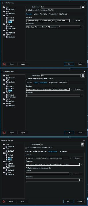

Got some problems tryingto compile anything...
Below are the compiler messages, and I have also added the compiler settings
compiler messages.jpg (43.07 KiB) Viewed 2248 times

Lord Grezington wrote:(1504) the PIC18 extended instruction set was enabled but is not supported by this compiler
Go into the configuration settings and disable extended instruction set.
