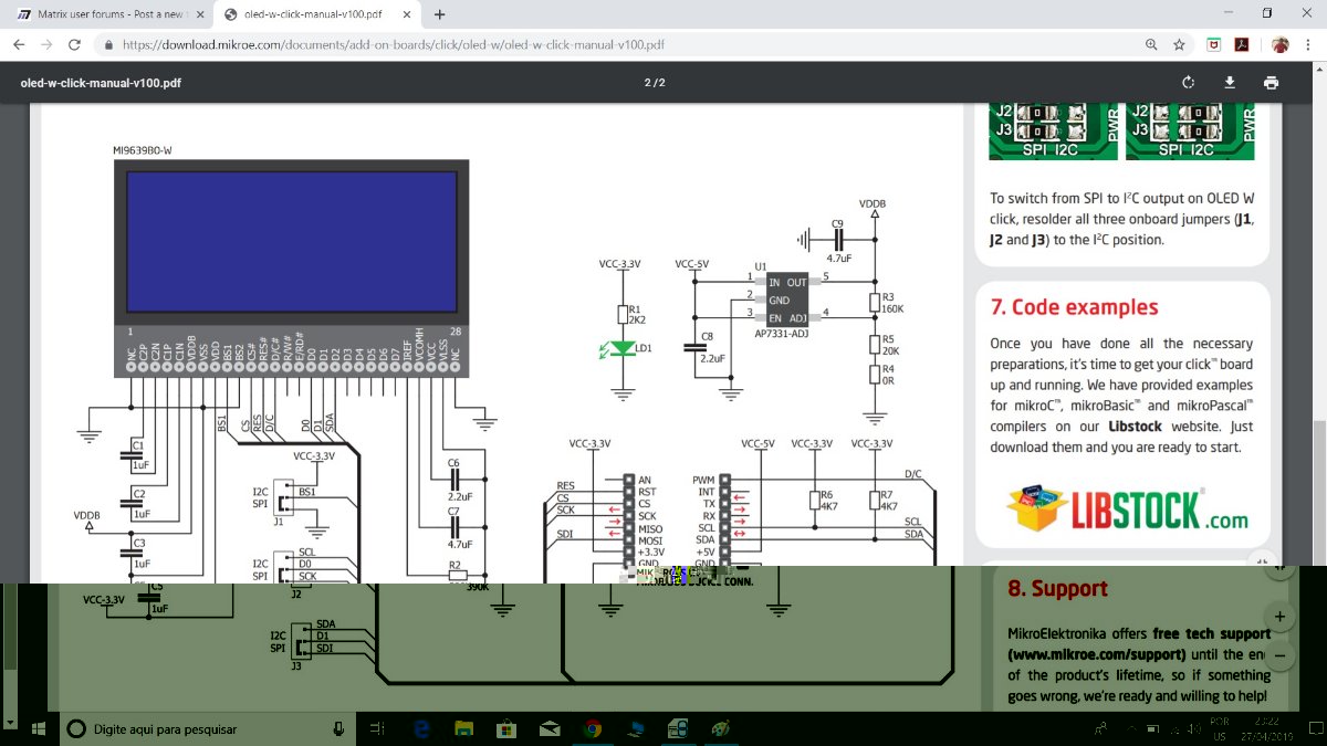

Hi all, I bought the OLED W click from mikroe and iam trying to run using the avalable component but it is not working. I dont have a D/C connection available on the component.
Running on the pic32mx795F512L, it would need these pins interfaced with the oled W click:
RST
CS
SDI
D/C
while on the component the connections are shown in the attached:
Is there anybody that could help modify the component for my application?
Rod

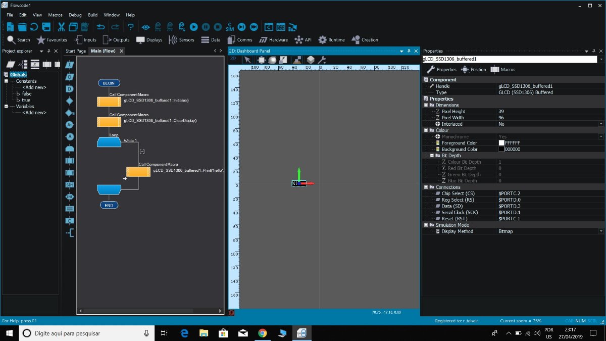

Hi all, Iam trying to drive the display ssd1306 and Iam having a hard time. :(
Iam using the bl0032 and click board with oled w (ssd1306) in SPI comm
Can somebody please help with this solution. I realized some folks were able to drive the oled C display
Rod

If you are using...
BL0032 E-blocks2 dsPIC Programmer
BL0101 E-blocks2 Click Adaptor board
Then the port pin mapping is as follows...
Reset - 7
CS - 2
SCL - 5
SDA - 3
DC - 6
For Port D/G this would map as...
Reset - G9
CS - D10
SCL - G7
SDA - D11
DC - G8
r_teixeir

LeighM, thank you very much, it worked perfectly.
I Appreciate
