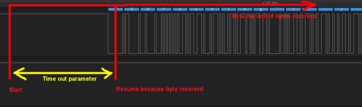

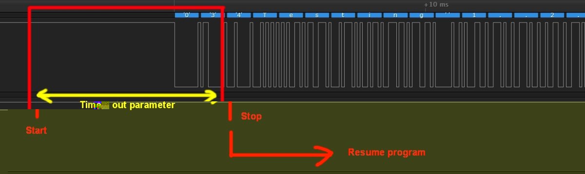

I don't understand how the timeout parameter in the UART receive string works.
The way I see it, the parameter just waits until the UART has a HIGH to LOW on the RX pin, and after that waits until the number of bytes in the #bytes parameter is fetched.
I think that when it starts receive bytes it stops its time out time?
I've made a few pictures of the way this parameter can be seen.
Could you please point which one is the right one?
OPTION1 (above)(timeout2.jpg)
When there is no HIGH-LOW change on the RX pin, and the time in the timeout parameter is reached, the program resumes from where the "receive string" is started
OPTION2 (above)(timeout3.jpg)
After the timeout time is reached, the program resumes even if the amount of byte isn't reached?
OPTION3 (above)(timeout4.jpg)
If there is a HIGH-LOW change on the RX pin before the timeout time is reached, the program keeps receiving bytes until the amaount of bytes in the other parameter (NumBytes) is reached.
I think option 1 and 3?

Yes, it is effectively 1 and 3
The timeout is the longest gap that the component will wait before it exits the function.
The gap can be before the received characters, within the string of characters, or at the end (if the requested string length has still not been fulfilled)

Ah, I've just spotted something in your original stream image:
The data stream starts with 0 3 4, but these are numeric 0,3,4 not characters '0','3','4'
The UART component ReceiveString function will stop receiving on a 0 or null character (this is a string terminator).
You would be better to use your own flow that loops using the ReceiveByte function instead.
Also when you come to print data from the receive buffer any print string functions will also stop at the 0.

But that won't be a great problem to solve.
I'm still recovering after a few days of heat >39°C, so I will damage my brain some more with nice liquids (on which you are so keen on)
I've never used the CB before, but my first experience look good.
I can store the received RX data in a variable, the only thing that is left to solve is that the last byte appears double in the variable.
