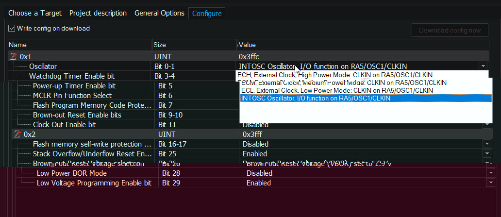

Hey, Just got the PIC8 Pack and I am playing with the chip and it looks like there are some config bit missing from the configuration.

Not sure what you are missing however the chip support 4 modes for Clock settings all 4 are available in FC

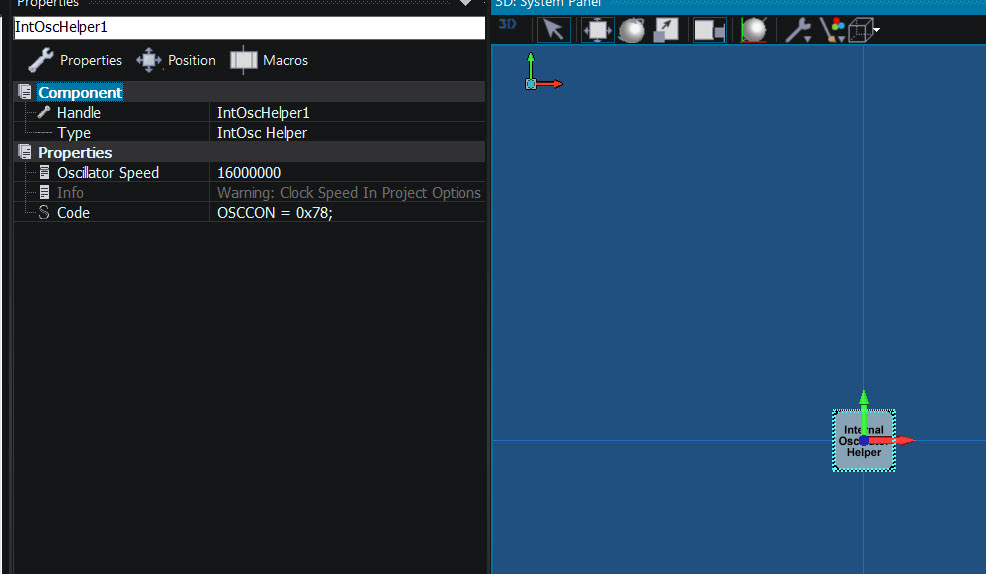

If you are looking to set the internal OSC at different speeds
(1) place a INTOSC helper on the 3D panel,then open properties set the clock speed you want (I used 16Mhz here)

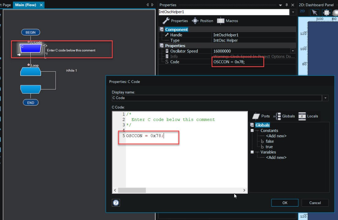

You will see a value for the OSCCON register in the properties now place a C icon at the beginning of your Flowchart and enter this value in a call
as I show here and now compile your chart and the chip will run at your selected Internal OSC frequency
