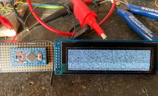

I did all kind of tests with my SSD1322 Oled display. simple sets with initialize and a circle being drawn. I did build a combination in 6800 mode. And in SPI-4 mode (SSD1322 buffered) both to no reaction of the screen whatsoever. in 8080 modus I at lease get the screen on but all noise. (all 64x256 pixels have a wild mixed gray value but stay exactly frozen like that) sigh... of coarse I measured out all wires and seem to be good :? .
If I take controller off the display still shows this image ...
Only thing I dont measure with my scope is a signal on data7. further all kind of signals.. I hope with the fix of FC7 SSD1622 macro there is something found.
I really do hope I made a mistake here :) but its pretty deep hidden then :oops:
