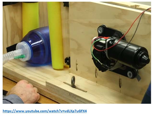

Looks like the resuscitator modification is the way to go (with or without the oxy supply).
I saw on Youtube some made in garage devices with or without electronics with one task in mind - to pump the air in a person lungs if that person is not able to do it or with so much pain in muscles that it is hard for him/she to do it.
Sure, it is not the pro or even semi-pro machine, but it can save some hours before that person can get some professional help.

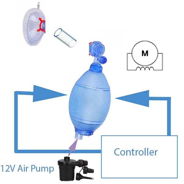

A very simplified diagram of device.

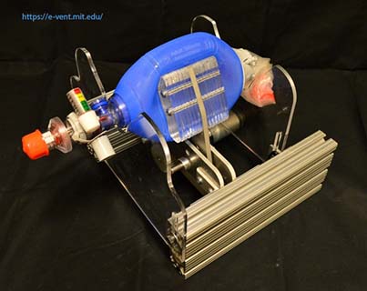

MIT Emergency Ventilator (E-Vent) Project
Do you plan to do it or not?
And yes, thank you for not deleting this topic.

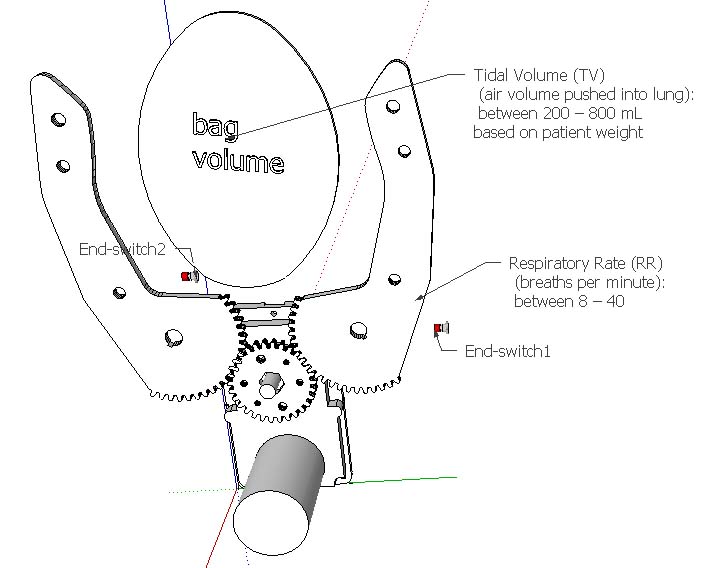

Looks like the main parameters are:
Respiratory Rate (RR) - (breaths per minute): between 8 – 40
Adjusted by changing the speed of motor
Tidal Volume (TV) (air volume pushed into lung): between 200 – 800 mL based on patient weight
Adjusted by changing the 'arms' travel distance

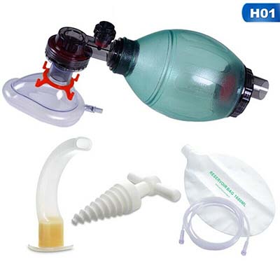

BMV or bag-mask-valve - the main component
Is a standard resuscitation bag, self-inflating bag, created for ambulances (etc) to be used by using the hand-manual pumping of air or air/oxy mixture into the patient lungs as the ventilation on room air is better than no ventilation at all. In this project only air intake will be used. The BVM consists of a flexible air chamber (the "bag"), attached to a face mask. BMV has valves.

I want to share my experience because I live in Italy and especially in the most affected area.
Yes, as you said, Covid problem causes severe respiratory crisis and oxygen is one of the main things the person needs,
Let's go back to the goal, I also thought like many lovers of the open source world how to make myself useful.
Let's start with simplicity, because not everyone has the means to make some complex parts, of course we have to use what we find "under the home store".
Watch this video:
https://www.youtube.com/watch?time_cont ... e=emb_logo
As soon as I saw it I appreciated the simplicity they used to compress the self-inflating bags
Car wiper motor connected by means of some gears in order to make a wheel spin in an eccentric way, the rest is even simpler.
What do you think about it? They used those big gears because they had them in stock.
Watch this video:

Thank you Ferla.
I think the biggest problem with this design is the gears.
Another problem is (I found it on internet):
Windshield wiper motors are NOT back-drivable, due to the worm drive, they lack integrated position sensing.
I couldn't see on video how did those guys solved the timing and positioning problem.
However I found on youtube another video with windshield wiper motor.
https://www.youtube.com/watch?v=vdLXp7uGFX4
In the first prototype, Galloway wrapped nylon webbing around an Ambu bag and attached it to the crank arm of a windshield wiper motor to apply the repetitive squeezing force. While the design worked, they still needed a cleaner design where the amount of squeeze (known as tidal volume) could be controlled more precisely.
As I understood the danger is in the over-pressurising the lungs. If timing is not correct the human will die.

Tidal volume calculations
Need some help with tidal volume calculations.
In what situation the sensitivity changes from 5 to 7 and up?

I have raised a discussion on Facebook group 'Open Source COVID19 Medical Supplies'.
My question is: what is the minimum needed settings for Arduino based controller?
Some people attacked me straight away by saying that I am creating a product for sale.
Thanks to moderator who deleted those posts.
My goal is to create a simple mechanical 'pump' in garage from tools we all have and use Arduino free code
to set-up the controller for this pump.
I am not sure what community is bigger, Arduino or Raspberry Pi.
I made a few projects on RPi and can say that it is a bit more complex than Arduino project.
But... Horses for courses.
What is good for one is not good for another one.
- (59.09 KiB) Downloaded 601 times
Re: Embedded system ventilator
Really depends on if you need the HDMI and Mouse/Keyboard interface which may swing things back in the favour of the Pi. Backup SD cards on standby
for my 2 pence worth on this I would use Arduino over a RPi, you don't have the boot up time and it's less likely to become corrupt and useless. Had lots of experience of the SD card on a Pi becoming corrupt due to it being switched off at the wrong time and having to be reflashed. An Arduino shouldn't have this problem.I am not sure what community is bigger, Arduino or Raspberry Pi.
