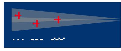

Lorenz beam blind-landing system
If the ground station transmits (in Morse code) the letter A (dit-dah) and the letter N (dah-dit) then robot will know own location in the operation area. If robot receives A all the time it is (left) from the base station. If robot receives N all the time - it is right from the station. When robot receives both letters with equal values (signal tone) the robot is going home on the center line.
It is some form of 'line following' idea, is not it? The line in this case is the equal values of A and N.
https://en.wikipedia.org/wiki/Radio_navigation
- LorenzSystem-1.jpg (22.84 KiB) Viewed 5664 times
