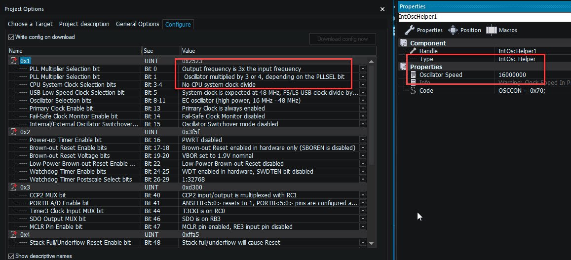

Does any one have a screen shot of the config settings, the clock speed under general and if the internal Oscillator helper is needed with this chip.
I am trying to set it to 48mhz using the internal oscillator at some point I want to play with the usb on the chip.

Hi Chad
try this setting, so your PIC is running on 48Mhz and a note: there is a similar PIC 18F25k50 with more ram for the same price.
Re: Bringing up a new chip 18f24k50 Having some problems.
Hi Stefan,
That's how I set it up.
Thanks for double checking my settings.

Hi Guys,
I do not have such an device however
In my opinion it should work as follow
You need to set the frequency of the Internal OSC use the OSC helper the setting of the PLL 3 or 4 times depend on the setting of the OSCCon register if 16MHz is used the you can only set the PLL to 3 which expects and input Frq of 48Mhz then
If you do not set the OSCCON register the internal OSC is running at it default which I expect is 4Mhz

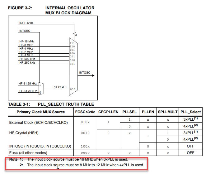

Hi Chad
The OSChelper gives all the possible Frequencies for the internal OSC
if you select 16Mhz then
the Internal OSC is running at 16Mhz which is the input frequency to the MUX unit then by setting the PLL bit to 3 times is 3 x16 = 48Mhz Clock frequency as you will see in the above post OSC block diagram

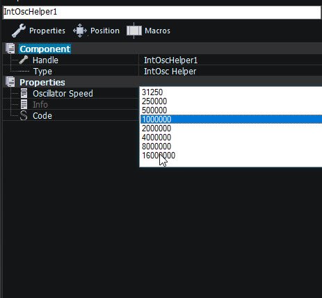

The error is because OSCFRQ within C code is not used on your current target device to set internal osc speed.
OSCCON is used instead.
For future reference, just use search (magnifying glass icon) and enter intosc, this is what QMESAR was referring to
That will bring the IntOscHelper up, so add it to 2D or 3D panel
IntOscHelper is used via it's properties to show the correct register name and value to give the required speed.
For example if using 16 MHz internal osc then x 3 pll = 48MHz, then set the IntOscHelper for 16MHz.
That will give you: Ignore that warning, as you have set target clock within project options to 48000000
You can copy and paste required value within a C code block.
In this case with
OSCCON = 0x70;
