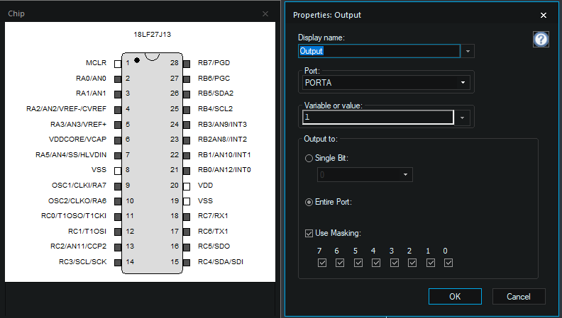

Working okay for me:
Port A Selection.png (39.27 KiB) Viewed 14705 times
Did it state you already have a file with the same name and do you want to replace the file in the desination?
