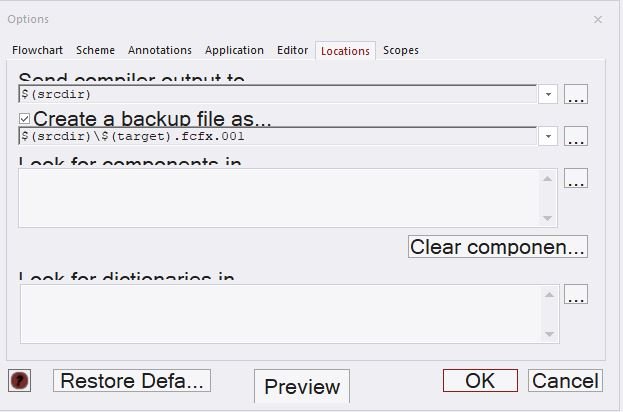

Hi I have got a problem with the text size in FC7 that I can not figure out. anyone know how to fix this?
The problem is only in FC7 so I do not think it is a windows problem.

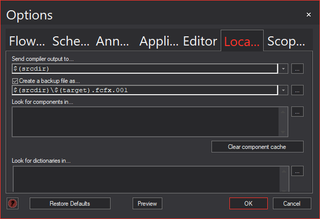

I have just tried to replicate this by changing the various settings of text size and DPI within Windows and I cannot make Flowcode look like yours.
If I choose "make everything bigger" under Windows display settings, then the text within the boxes (of the window in your screenshot) becomes large but the labels above these boxes remains the same:
If I choose instead to "make text bigger" then the text in both remains small and I get the following:
The only other thing I can think of that could potentially cause this issue is a missing system font, but that seems unlikely. Perhaps others on this forum will have a suggestion.

I suspect it has something to do with my screen resolution. I use a 49" gaming display with a resolution of 3840 x 1080. Is FC compatible with this resolution?
when I disconnect that screen I can read all the text on the other screen. but must disconnect for it to work

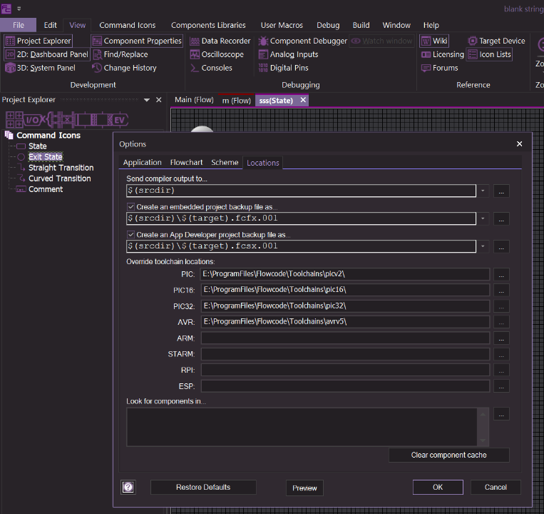

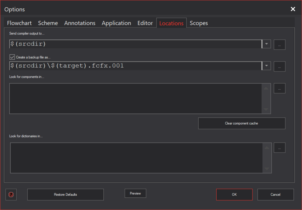

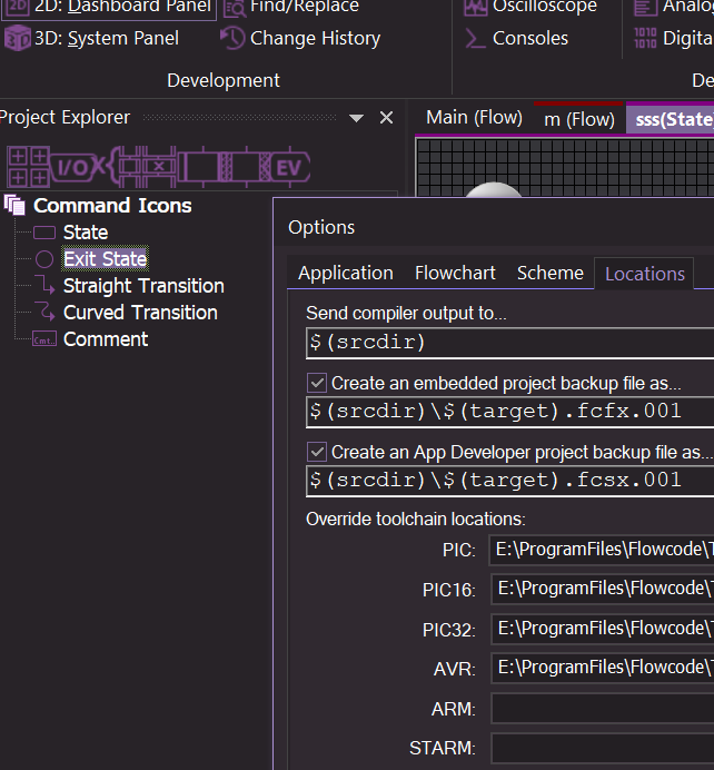

We've just bought a 32" 4k monitor to test this problem and I cannot replicate the problem in the initial post.
I have played around with multiple settings within Windows and also played with the compatibility settings for Flowcode's exe. Whilst I have noticed some issue, such as toolbar buttons are sometimes squashed or cropped, the only text issues I've been able to replicate have been similar to the images I posted earlier in the thread.
What's more, I have now changed the settings so that Flowcode looks a lot better on my 4k monitor - i.e. the text is not too small and it has all scaled at the same ratio. See the images below (the first might appear blurry because it has been squashed by this forum, so I've attached the second image to show what it really looks like).
I don't know what to suggest. From the initial post I had assumed Flowcode was not able to render correctly on 4k monitors, but that doesn't appear to be the case from my tests (apart from issues with toolbar buttons). You might want to play with some of the settings, in particular the compatibility tab settings for high DPI for the Flowcode exe file (if you're doing this on Flowcode v9, change the FlowcodeV9.exe in the "data" folder, not the launcher exe).
