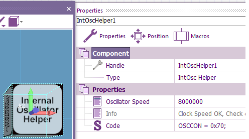

To take the guess work out make it much easier for you, just search component s for intosc
Then add the component to your dashboard.
Right click on the IntOsc component when on the dashboard and select properties.
Enter he required frequency and you will see the C code to copy and past.
In your case if enter 8MHz:
