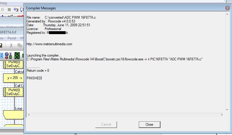

Same problem of compiling in Vista SP2: no hex file and i have key for full version today.
In XP with SP3 no problem work ok !
Not solved with previous post.
What i can do?
Thanks in advance.
Re: Flowcode V4
Hello
Have you tried the fix documented here?
http://www.matrixmultimedia.com/support ... .php?t=550
I am running Vista 64 and Flowcode v4 is working 100% fine with the above mentioned fix.
We have also tested using Vista running in a VMware virtual environment and this has also been working well.
ITISVARESE
Posts: 56
Joined: Sat Jul 07, 2007 3:00 pm
Has thanked: 9 times
Been thanked: 3 times
Re: Flowcode V4
Post by ITISVARESE »
Yes i tried it and not work on Vista SP2 32;
not have error but no compile like previuos user says in this discussion....

saschech@gmx.de
Posts: 714
Joined: Wed Jan 31, 2007 12:41 pm
Has thanked: 1 time
Been thanked: 26 times
Re: Flowcode V4
Post by saschech@gmx.de »
Hallo
To different installation with the thame error....
I think it is not a mistake of the pc
Regards wolfgang

I have exactly same problem of V4 not compiling to hex.
I have checked and long file names is active for V4.
Operating system is windows vista home premium
I am trying to compile DC PWM 16F877A found in V4 examples.
For some reason, boost c complier is not activated.
Here is a screen shot.
V4 no hex.jpg (42.96 KiB) Viewed 20616 times
