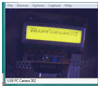

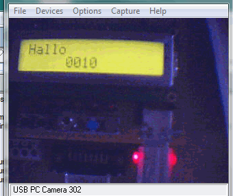

and i have return code = 0 , but if i compile to chip,my hardware dont work.
I change compiler-option to boostc , compile to chip,the thame code work on my real hardware.

I have fixt my code with put in a dummy for:
^ (195) expression syntax
^ (312) ";" expected
To build a *.asm file,please can jou give me exactly compiler settings;because i have problems with build.
If i can help jou more , feel free.
Regards Wolfgang

After i put in " the supplementary code" , compile to chip , i can show a reaction on my lcd-display , but not the correct one.
The blinking ledΒ΄s are out of work.
Regards Wolfgang
Regards Wolfgang

Re: Flowcode v4.2 Beta Testing
Hello Benj
Unfortunately no success .
Regards Wolfgang
Regards Wolfgang
Hello Benj
What is the difference between a "c-code-macro" and the "Use supplementary code" in the project option?
In both cases , i put in the code , i found the code in the hex file.
Compile to chip in flowcode i have no success ; if i load the pic over MPLAB > PICKit3 it works , but my first line in the lcd-display show incorrect symbols.
Regards Wolfgang
Regards Wolfgang
