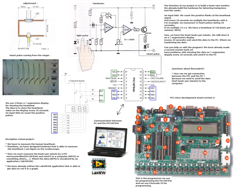

The intention of our project is to build a heart rate monitor.
We already build the hardware for detecting hartpulses. And this works.
On input RA0. We count the positive flanks of the heartbeat signal.
And every 10 seconds we multiply the heartbeats with 6.
For example: we measured 12 heart pulses during 10 secondes.
If we multiple 12 x 6. We have a heartbeat of 120 beats per minute(=BPM)
Now, we have the heart beats per minute. We willl show it on a 7 segementen display
(every 10 seconds) and send this data to the PC. Where we monitoring the data.
Can you help us with the program? We have already made a second counter buth we
have problems with showing the data on 7 segmenten display every 10 seconds and send it to the PC

Hey Keith,
Here is a better image of the circuit for you.
Components:
• LED3 = High intensity led, at least 1000 mcd.
• LDR1 = light dependent resistor;
• ( resistance in the dark = 1M Ohm and resistance in light = circa 300 Ohm)
• R1 = 100K Ohm
• R2 = 1K Ohm
• R3 = 47K Ohm
• R4 = 10K Ohm
• R5 = 220 Ohm
• R6 = 1K8 Ohm
• R7 = 220 Ohm
• P1 = 100K Ohm (potentiometer)
• P2 = 100 K Ohm (potentiometer)
• C1 = 470nF
• IC1 = LM358 ( comporator).
Discripton circuit:
LED3 shines through the finger on the LDR1. Each time the heart is pumping a 'wave' blood through the finger. The finger is getting darker inside so less light falls on the LDR1. This phenomenon is measurable and convertible to an electrical pulse. For each heart pulse the resistance of the LDR1 changes and the voltage on the input of comparator IC1a also changes. The reinforcement of the opamp is adjustable with potentiometer P1. The sensitivity of the circuit is adjustable with potentiometer P2.Output driver transistor T1 controls LED2 and will blink on the frequency of the heart. Remark: You must see that LRD1 only catch the light that’s comes from LED3 trough your finger and not the light from the environment.
which can lead to interference. So you need to experiment with the construction of LED3 and LDR1. We used a box (see picture).
I hope i helped you with this post,
Greetz,
Dieter

Using a lager chip is not an option because of schoolbudget and efficiency of using pins.
It's perfectly possible to use the PIC16F88 for our project. How can we change the macro LED7Seg4(0) ?
Because we can only select port A or port b for the whole 7 segments Display. Because we lose RB5 for RS232
That's not efficient in our project. Is there no way to change the pins for the macro to free pins?
Is it possible to use this configuration ( see picture below).
I hope you understand our problem, Benj
How can we solve this problem?
Thx for helping us out with the problem.
Greetz,
Dieter
