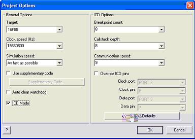

Firstly we have to setup Flowcode to use the FlowKit device. This is done via the Project Options window, which is available from the View menu. The code to drive the FlowKit is enabled by ticking the ICD Mode option. On the right hand side of the window are some settings for the FlowKit that define some of the basic functionality.
Breakpoint count - defines the maximum number of breakpoints you wish to enable in your program. The more you have enabled the more memory the ICD driver code requires on your embedded target device.
Callstack depth - Defines the maximum number of jumps in your stack. This will be 8 by default but means that software stacks such as the one included with BoostC can still be used while debugging.
Communication speed - Defines the bus speed between your embedded device and the FlowKit. The number represents a delay so the smaller the number the faster the communications speed. This is automatically calculated based on your clock speed to provide an optimum communication speed.
Override ICD pins – Allows the ICD pins to be manually specified instead of taking the default values from the Flowcode definition file (FCD).

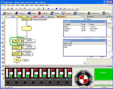

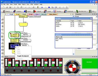

Variables can be added to the debugger in the same way as the simulation by right clicking the Variables window and selecting 'add variable'. Note that the variables window is only available when the ICD or the simulation is running or paused.
Breakpoints can be set or cleared by right clicking a flowchart icon and selecting toggle breakpoint. When a program has active breakpoints the debugger will pause on the specific icons that have their breakpoint enabled.

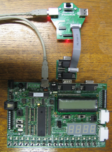

HP488 development board
When using the E-Blocks adapter board as shown above the ICD pins are automatically routed to bits 6 and 7 of the port. The E-Blocks adapter board even allows for E-Blocks to be connected so you are not sacrificing an entire port for the ICD functionality. For the setup shown above I have to manually change the ICD pins to Port C pins 6 and 7. If pins 6 and 7 are not an option for you then you can instead wire single pin connections from the FlowKit to the E-Blocks adapter board remembering to connect the ground as well as the ICD clock and data pins.
Other hardware that can be used in this method:
EB019 AVR Board
EB006 v6 or earlier
ECIO Application Board
EB031 ARM Board (when Flowcode v4 ARM is available)
MIAC

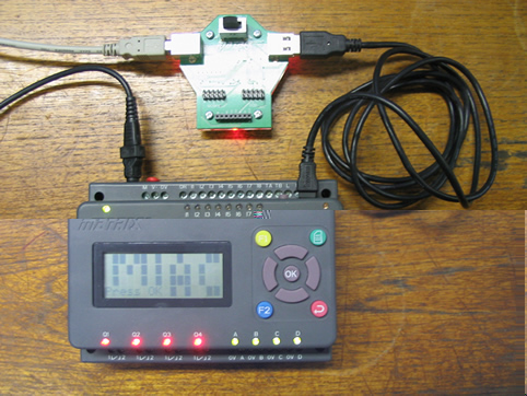

When using the FlowKit with one of our USB Bootloader products it is possible to use the same USB cable for both re-programming and debugging. These USB products all have their default ICD pins set so that the USB connection is the default connection for ICD communications. Debugging the hardware is achieved by moving the switch on the FlowKit to the ICD position. Programming the hardware is achieved by moving the switch on the FlowKit to the Prog position.
ECIO PIC
ECIO ARM (when Flowcode v4 ARM is available)

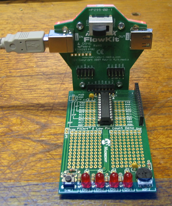

Microchip development boards generally come with an ICSP header that is used with a PICkit programming tool to provide re-programming functionality. The ICSP header on these boards can also plug directly into the single pin connections on the FlowKit so that the board can be both powered and debugged at the same time via the one connection. For other third party hardware, wires can be connected from the socket on the FlowKit directly to the I/O pins of your choice. The ICD pins are labelled as ICDC and ICDD, which stand for clock and data respectively. You will also need to connect a third wire for ground if you are using the individual wire connections.
EB019 AVR Board
EB006 v6 or earlier
MIAC

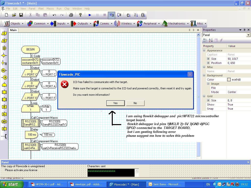

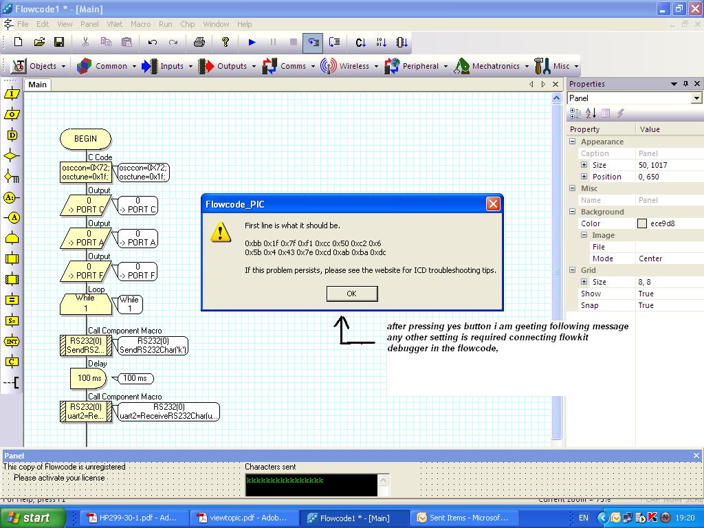

Using the FlowKit ICD Tool
HI
I am using HP299-flowkit debugger and third party pic 18f8722 target board,
I have following query about HP299-flowkit debugger tool:
1) I am using MPLAB IDE ICD2 to download the program into target board,
2) after programming i connected HP299-flowkit debugger tool to target board,
a) flowkit debegger tool switch is in ICD mode,
b) from the target board mclr,+5v,gnd,pgc,pgd pin connected to the flowkit debugger,
3) In flowcode program project option selected ICD mode,
4) After this connection i click on step into button of the flowcode,
5) After this i am getting following error and also flowkit debugger led blinking regarding this issue i attached image file,
please kindly go through following query
please help me out how to solve this problem,
Thanks & regards
keshav

Re: Using the FlowKit ICD Tool
If you make any changes to Flowcode then it will assign a new number to check the program is up to date. If at any time a star appears in the Flowcode title bar then something has changed in the program resulting in a new number being generated. This could include going into a window such as project options and making no changes except clicking ok.
Therefore when you compile and program your device make sure that nothing happens to change the Flowcode program and then the numbers should match and the debugger should fire up correctly.
Hello
Presently I am using MPLABICD2 and HP299-FLOWKIT debugger to download and debug the code from target board PIC 18F8722 microcontroller,
1) I activated ICD feature in project option window using tick mark,
2) After finishing settings in project option and device configuration bits,
3) Using compile option compile flow code program,
4) Using Microchip MPLABICD2 downloaded the code into the target board,
5) After finishing download program into the target board I disconnected MPLABICD2 connection from the target board,
6) Using Flow kit debugger ICD pins a)MCLR b)VDD c)GND 4)ICDD 5)ICDC Pins connected to the target board, please
clarify these connection?
7) ICD pins directly connected to target board PIC microcontroller it does not Connected to any other external hardware
After FLOWKIT debugger connection, I click start icon in flow code,
9) It does not connecting, continuously I am getting following message “The Program in the chip is out of date, please
recompile your flowchart and send it to The chip”
10) Whatever you given in the flow code ICD debugger guide PDF file, I am Following same procedure please suggest
me how to solve this problem,
Hello keshav@solus.in
I had a similar problem when using internal oscillator on 4MHz. This is what Ben posted:
Hello Medelec
Success I know why!!!!
Ok when the ICD is enabled the program will run until it gets to the first icon in your flowchart. It will then wait there until told to proceed.
Flowcode is expecting the clock speed to be 4MHz however when the chip first starts using the internal oscillator the clock speed is set to 31.25KHz.
It is only when the first flowchart block is called that the clock speed is switched to the 4MHz setting.
So to work around this problem is fairly simple. You can do this using a custom component or any other component you happen to have in your program. Select the component and click the custom code button. In the custom code window select the Initialization macro and click edit. In here add your line of C code to configure the internal oscillator. Now click OK to exit the custom code windows and delete the icon containing the oscillator frequency change.
