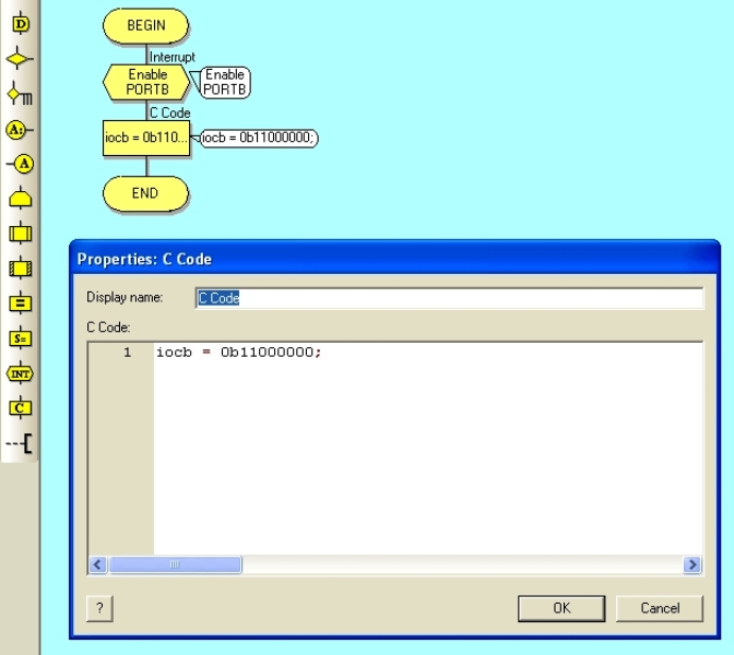

May i reply instead Ben? Moreover Ben is my mentor on this issue. The PORT B interrupt (or IOC = Interrupt On Change state according to Microchip) is available from RB.4 - RB.7 regarding your micros P16F876 and 913. In new generation PICs, like P16F887, it is available on all pins of PORT B, from RB.0 up to RB.7. When you enable the PORT interrupt in FlowCode, by default is applicable on all pins of PORT B. You can exclude some pins from this interrupt by masking them. But this can been done only by using a C code icon. For example, if you want to apply interrupt only in RB.6 and RB.7 pins you have to put a "C code" icon exactly after the "Enable PORT B" icon and to write this command:
iocb = 0b11000000;
In this way, b7 and b6 pins of Port B are masked and used as interrupt sources, while all other pins are excluded and can be used for other tasks. Please don't forget to delete everything is written inside the "C code" icon when you open it for first time, to place the command in the first line and the ";" at the end of command.
iocb = 0b11000000;

- iocb.jpg (105.58 KiB) Viewed 7177 times
