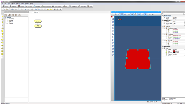

The post was great and looked simple enough so I thought I would have a go at it myself as well as making a Flowcode component to allow me to simulate and easily develop programs for any size of LED cube. I planned on a larger single colour version of the cube but then realised that to double the display meant potentially quadrupling the number of LEDs and connections required and so scaled down my thinking a bit and instead went for the RGB LED approach. This then went further and I thought up a way of making it a useful enough item that I could get away with installing into my living room. Being inspired from infinity mirrors made into tables on YouTube I thought what about we box up the LED cube with glass and mirrored car window tint and create an infinity cube. Installed onto the center of a nice largish second hand coffee table, I might just get away with that one 😉

Attached below is the current Flowcode RGB LED Cube component source in it’s unfinished state along with the PCB design files and bill of materials for the project.
