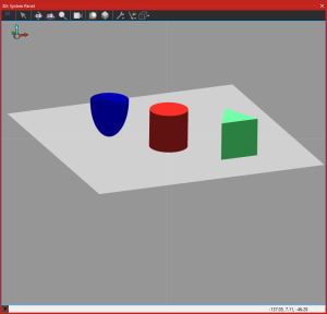

The System Panel is opened by selecting it in the View menu. Unlike the Dashboard Panel, the System Panel is designed to simulate a 3D environment. It is best suited to designing and positioning objects as all aspects of an object can be viewed. Once an object is designed, it is often used in projects via the Dashboard Panel.
When it opens, you see a central coloured square, called the Table top, set against a coloured background. The colours or images of both are set in the 'General Options'. GeneralOptionsIcon.png
The System panel has a Shapes toolbar running vertically down the left-hand side, and a Controls toolbar running horizontally across the top.
Components can be added to the System panel from the Components Toolbar. Then, input devices like switches can be operated to control the progress of the simulation, while output devices, like LEDs show the result.
Dashboard or System Panel?
To find out more about the differences between the Dashboard and System panel and also recommendations on how to use the two panels for different types of projects please see the article Choosing your Simulation Panel
Table top
The Table top provides a 'surface' on which components are placed. It is a flat plane that objects can be placed on. When locked to the Table top, all objects sit on top of it and interact as solid objects.
It is also useful as a surface for shadows, giving a sense of depth and orientation. The rotate mode of the camera treats the table top as the 'ground' and keeps the camera orientated with this in mind.
