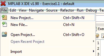

Open the New Project menu:

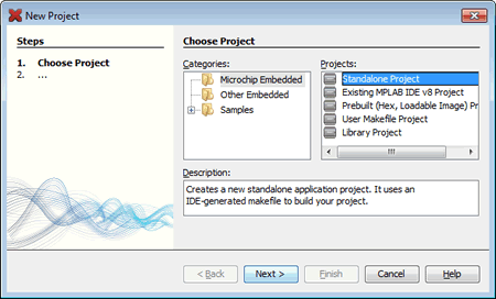

Select the project type:

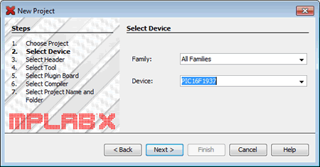

Select the microcontroller device:

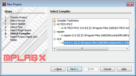

Select the XC18 Compiler:

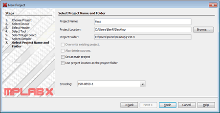

Give a filename for your new project (I called mine First) :

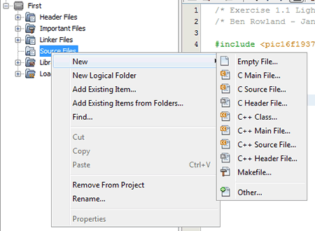

Add the sources for the project using the 'Add files' option :
