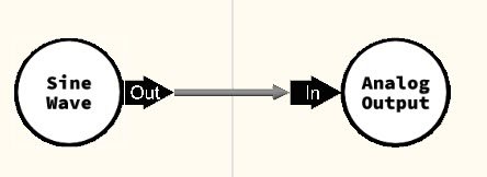

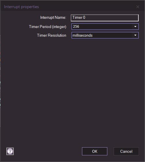

In your video everything works so simply but..
I tried to control the DAC of the ESP32 with the DSP.
Even on the beginn with the setting of the interrupt is not clear to me how that works.
At the end there should be a sinus signal of about 1 kHz on the DAC output, so a 10 kHz interrupt frequency would be good.
And as soon as I turn on the interrupt, the program crashes
how to set to 10khz
Simple dsp function:
