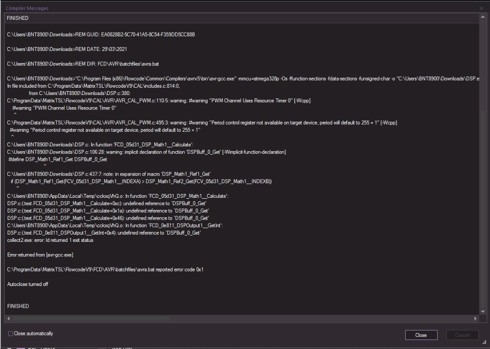

I'm traying to replicate the same thing with an arduino uno
but i get this error( see attachement)
what do i wrong?
kind regards
what do i wrong?
kind regards

Please can you try going to Help -> Library Updates, Then change the Files in use setting at the bottom of the window to Full Database. This should download some new files and after reloading your project hopefully it will all compile ok for you now.
One thing I did notice is the DSPWaveGen componnent Calculate Data property is currently generating a compile error when set to Yes so I'm going to try and investigate this for you now. edit - this should also be fixed now too.
