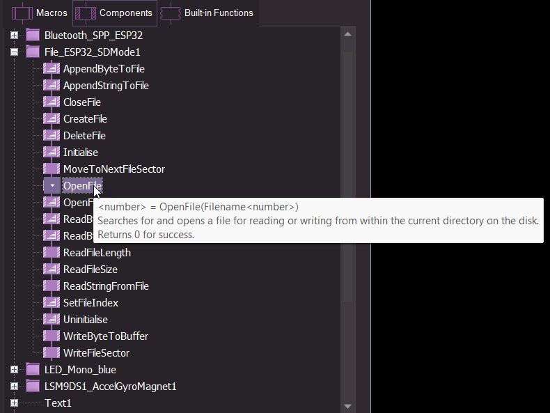

A question about the file open. In the version Before, if the file does not exist on the SD card, it does not return 0.
But now if the file does not exist, it creates the file.
This is not practical. I use this to determine if a file already exists.
Is there a way to test if a file already exists?

How can I prevent existing files from being overwritten or data attached?
File open ? it always returns 0 if it has created a new one or if it has opened an existing one.

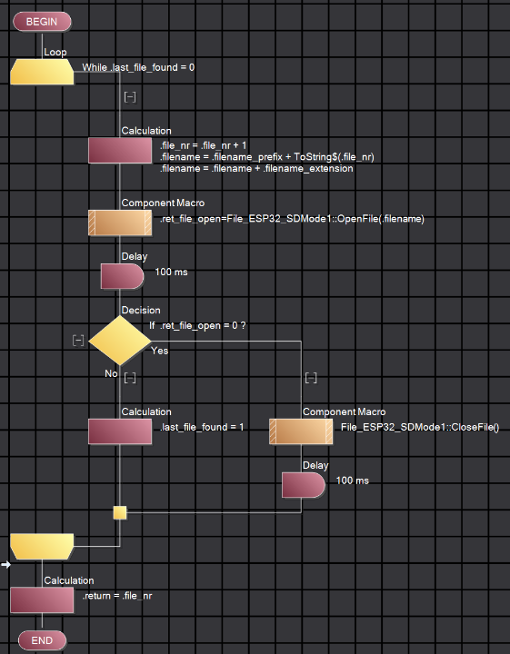

I would like to do the following. When I start the recorder I read the card if record1.wav is present, then record2.wav and so on. Until, for example, record7.wav is not present (return a 1 instead of 0). So I know that my next file should be record7.wav and then nextnext record8.wav and so on. This works well with the "old SD-card component" Perhaps there is a better method .
after a restart returns a number for the next filename:

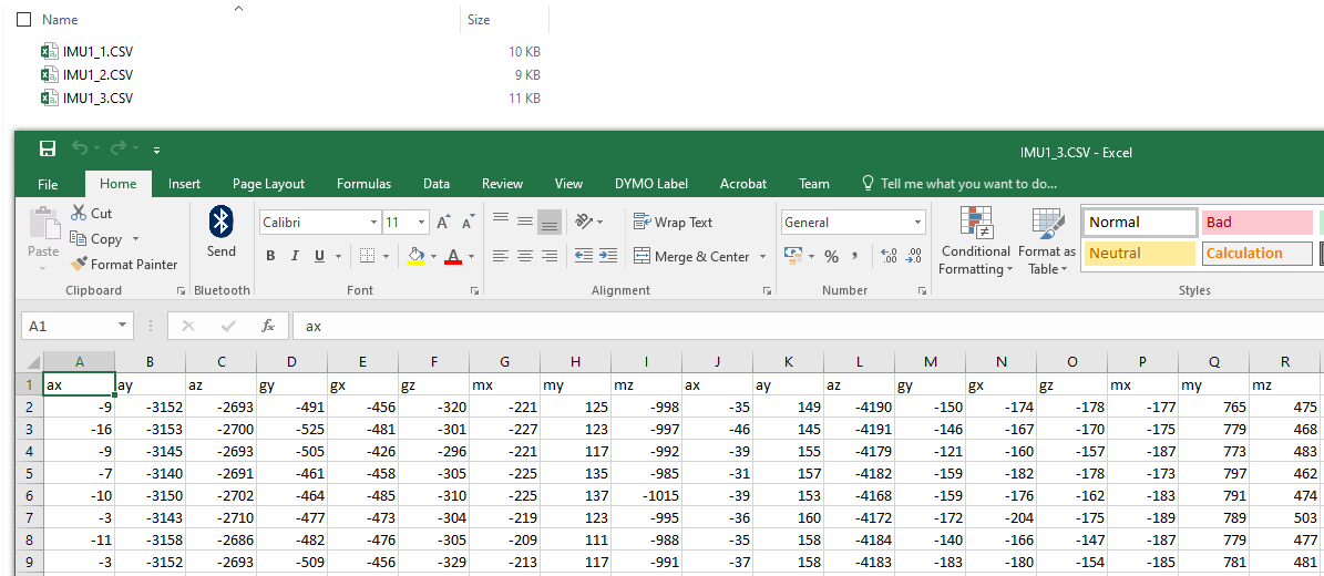

It is so easy to create an excel file with Flowcode. With the help of my macro "file_last_file_found.fcm" I can, for example, make two recordings and then switch off the recorder completely. When I switch the recorder on again, this macro finds the number for the next file.
I my application IMU1_3.csv

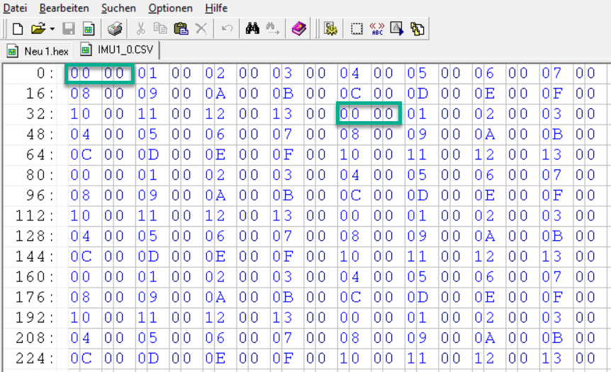

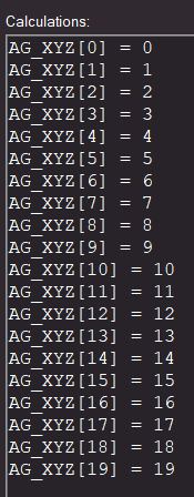

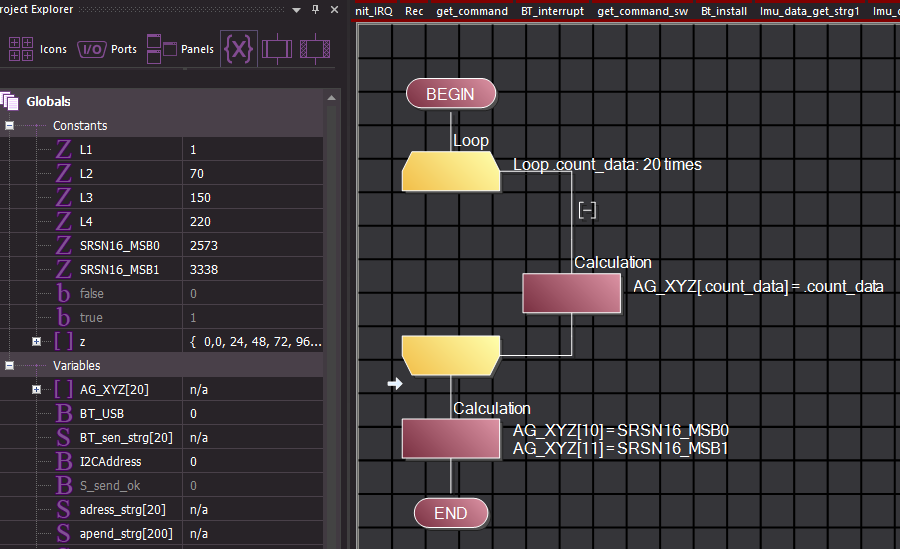

If i append an array with number 0-19 in a loop, it's working fine.

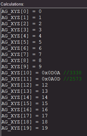

But if i change value 10 and 11 to a special value like "\r\n" and "\n\r" in hex value
its not append the rest of the array anymore.
Set the array:
result is perfect:
Set the array with special char:

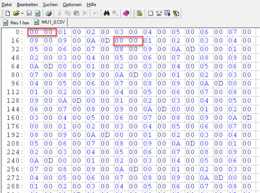

result is not complet after the 0x0A0D:

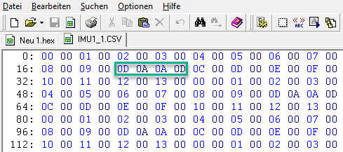

Right ok that is odd, looks to be something deep within the fputc function which is returning an error when it gets those characters. It writes both bytes in the INT before checking the error return. I can't look at the library itself to see what it's doing because it's precompiled.
I've had a go at simple ignoring the error in all of the AppendArray functions and hopefully the latest version will work ok for you now. Could be the error is just indicating an end of line character has been received.

by stefan.erni
It's working perfect! Thank you.
I checked it and created the array a little more elegantly.
