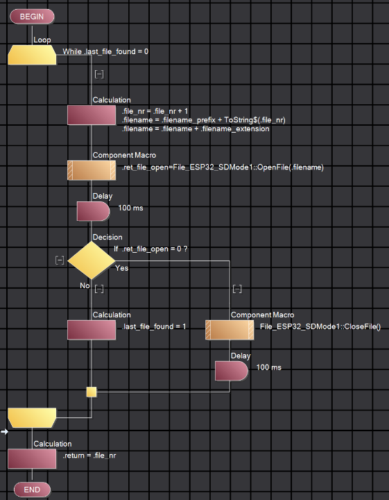

I would like to do the following. When I start the recorder I read the card if record1.wav is present, then record2.wav and so on. Until, for example, record7.wav is not present (return a 1 instead of 0). So I know that my next file should be record7.wav and then nextnext record8.wav and so on. This works well with the "old SD-card component" Perhaps there is a better method .
after a restart returns a number for the next filename:

It's working perfect!
It is so easy to create an excel file with Flowcode. With the help of my macro "file_last_file_found.fcm" I can, for example, make two recordings and then switch off the recorder completely. When I switch the recorder on again, this macro finds the number for the next file.

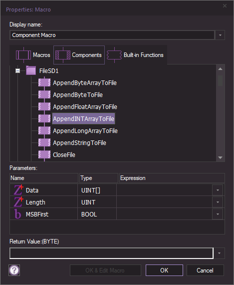

Sometimes I have to create a binary file instead of an Excel file.
I can save a byte array, but that is a bit complicated because I have an integer array.
Would it be possible to add this also with ESP32_SDMode (4Bit) like the old SD-component?
AppendINTArrayToFile:

Excellent glad it's working correctly for you now, I've now added the INT, Long and Float array read/write functions so hopefully that will help.
Please let me know if you have any issues.

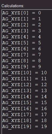

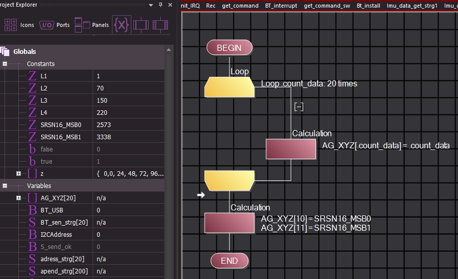

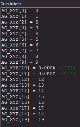

If i append an array with number 0-19 in a loop, it's working fine.
But if i change value 10 and 11 to a special value like "\r\n" and "\n\r" in hex value
its not append the rest of the array anymore.
Set the array: result is perfect:
Set the array with special char: result is not complet after the 0x0A0D:

Hi Stefan,
Right ok that is odd, looks to be something deep within the fputc function which is returning an error when it gets those characters. It writes both bytes in the INT before checking the error return. I can't look at the library itself to see what it's doing because it's precompiled.
I've had a go at simple ignoring the error in all of the AppendArray functions and hopefully the latest version will work ok for you now. Could be the error is just indicating an end of line character has been received.

It's working perfect! Thank you.
I checked it and created the array a little more elegantly.
