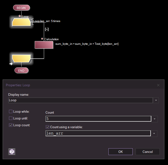

Hi Dirk
What about this way?
And make sure that the sum is not greater than the maximum value of an integer

Super Stefan!!
Works great!!
