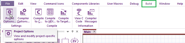

Hi, Happy new year to you.
When you what to change the target of your project, you use the Build ribbon then Project options as can be seen in the image below:
Build ribbon.png (51.71 KiB) Viewed 7876 times

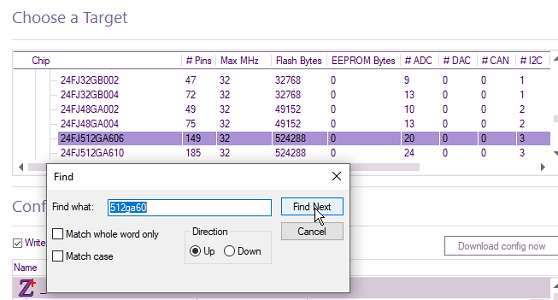

A tip for changing target.
Right-click on any random target, then select search.
Enter the partial name of the new target in the find window, in your case
512ga606
Find target.png (69.56 KiB) Viewed 7876 times
Click on Find next.
When you change your target, you much make sure all configuration settings within the Project Options match your hardware.
Then check all pin connections for every component and inputs/outputs are also correct.
