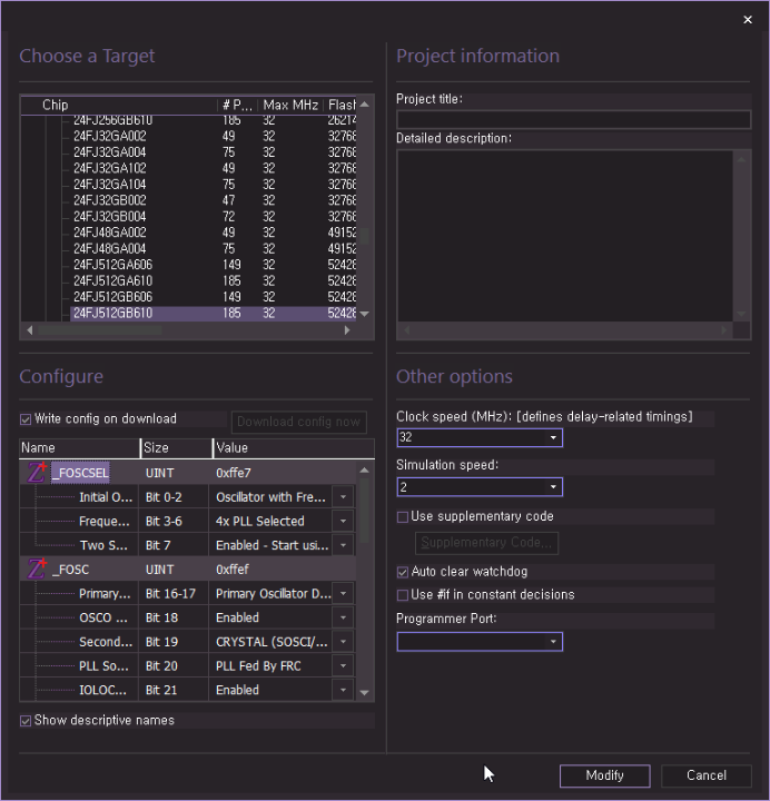

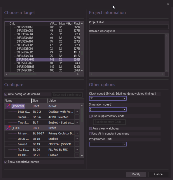

I'm working on a project using PIC24FJ512GA606.
When I select the project option and compile and download it, an error that the device is not recognized appears.
And when I look at the project options again, I see the other chip selected. How to solve it?
Please help.
thank you.

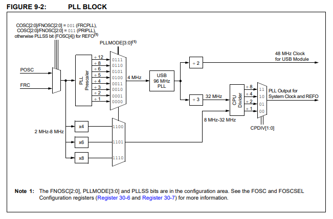

Looking at the PLL Block for the chip, max system CLK is 32MHz.
You need to lookup the datasheet to see what Configuration Bits and necessary registers to set.
PLL BLock.png (65 KiB) Viewed 11311 times

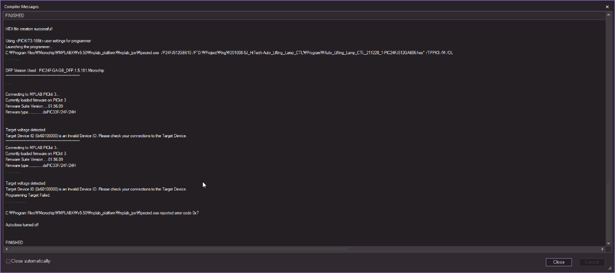

The PICkit detects an DSPIC33FJ32MC302, so either you are using the wrong chip or you need to check your hardware setup.
By the way, next time you post compiler output please go to the ….msg.txt file in your flowchart folder and copy-and-paste the text in the file, not a screenshot for easier reading for us.

I post the message file.
Auto_Lifting_Lamp_CTL_211228_1-PIC24FJ512GA606.msg.txt
(9.59 KiB) Downloaded 746 times

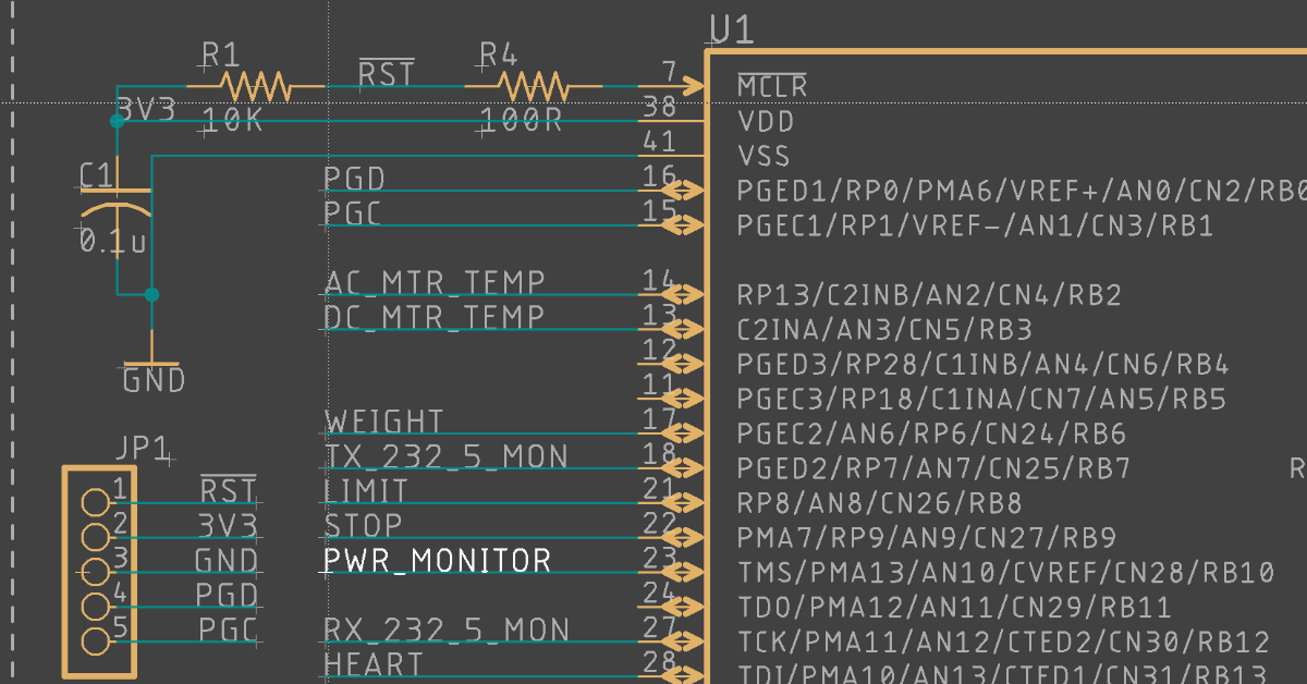

A bit more information would not hurt. How did you connect the two? Which pin to which pin? What else is connected?
seokgi
Posts: 246
Joined: Thu Dec 03, 2020 1:43 pm
Has thanked: 8 times
Been thanked: 9 times
Re: PIC24FJ512GA606 download error!
Post by seokgi »
Post my drawings.
