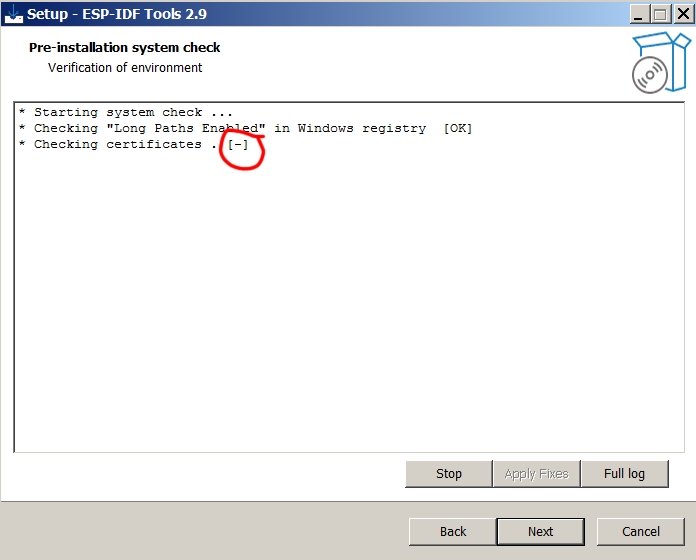

I've been trying to install the ESP32 toolchain as described in "Flowcode ESP32 Toolchain Installation guide".
Used version 2.3 on a (genuine) Windows 7 PC.
The installation always get stuck on "checking certificates". This stays running for ever.
If I (after a few hours) click "next" the installation goes further but no sign of GIT or Python after the installation.
Any suggestions?

Your setup is showing Setup - ESP Tools 2.9
The official instructions show the download link and installing 2.3.
Latest is not always best and later versions have not been tested, therefore can't be supported via the Flowcode forums.
You will need to stick as close as possible to versions shown in the guide of all the different tools, e.g Python 3.7, ESP v4.1 or the nearest to it.

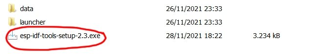

I downloaded the file in the path of the document and the name of the downloaded file is "esp-idf-tools-setup-2.3.exe"
I saw that too, but I guess that I downloaded the right file?

Martin you are brilliant,
Now I've downloaded the file from the Matrix website and I get a whole other screen when I execute the file.
Message to all: don't download the 2.3 version from the ESP link because this will lead you to version 2.9 (that is named 2.3).
I hope this may solve problems for other users.

Yes, You are indeed correct.
Don't download from ESP link, Download ESP Tool chain from here instead.
Are you up and running now?
