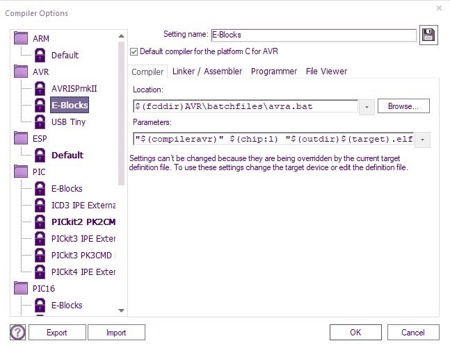

There's something not quite correct with either the toolchain setup or settings in your Flowcode. According to your error logs the compiler isn't getting started.
It might help if you could post screen shots of your Flowcode settings dialogs. Toolchain location screen etc

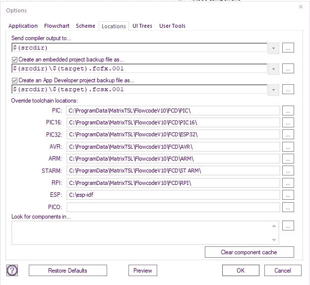

Re: Arduino Uno connection to ILI9341 TFT LCD

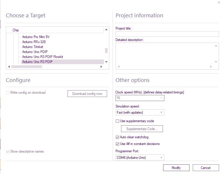

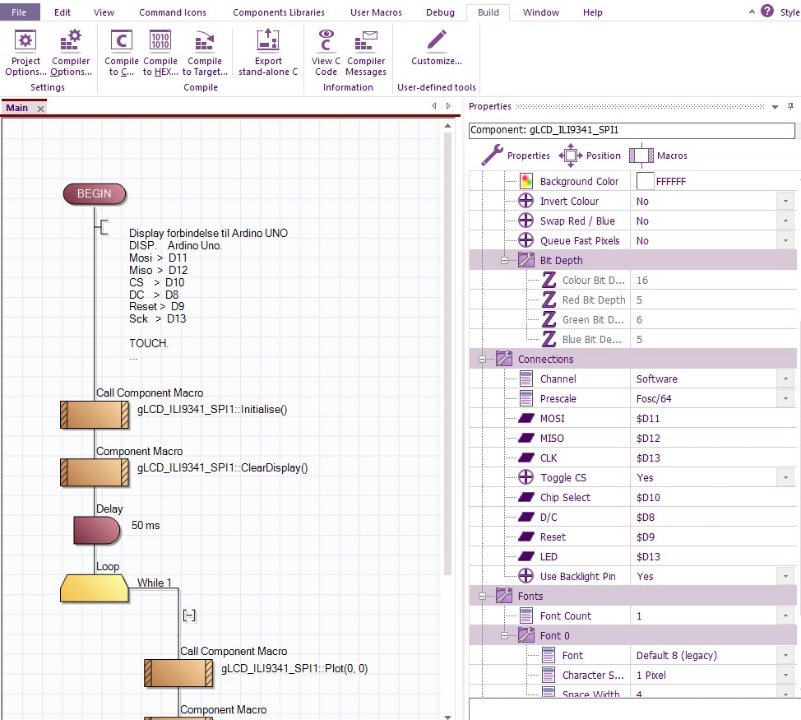

Hi LeighM
I have attached some screenshots .

by Steve-Matrix
Those toolchain locations look wrong (apart from the ESP). These are pointing at the %PROGRAMDATA% location which is used internally for Flowcode's library updates.
Instead, these need to point to the location where you have installed the toolchains (there are separate installers for these on the Flowcode download page). Normally the toolchain itself 'tells' Flowcode where the toolchain has been installed to and these locations are set up automatically. By default, most of the toolchains will install themselves in the "C:\Program Files(x86)\..." location.

Hi Steve-Matrix
Flowcode_Compiler_AVRv5 - HI have to re-install.
It helped Ardino Uno R3 which now runs well Flowcode v11
I am trying to use ILI9341 SPI Display on different devices.
So thank you very much for the help.
