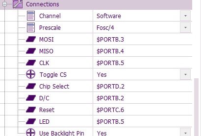

CS > D10
Reset > D33 (Port D.6)
DC > D27
Mosi > D11
Sck > D13
Miso > D12
Led > (Port B.5)
D/C > ?

See my setup in Connections below!

If you look in the chart you initially attached, you will see that under Build>Project Options the target is set as an ESP32_Wroom_32 not an Arduino.
If you change the target to an Arduino and then check pin allocations, you may be get better results.
I've often forgotten to change the target from previous, only realising when things wouldn't work.
