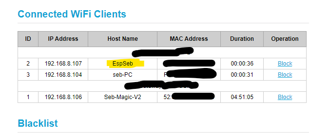

hi,
I don't have menuconfig.bat in FC9 or FC10
I'm always access to menuconfig via CMD
Menuconfig who is very usefull
To acces to menuconfig and change ESP Hostname.docx
(415.98 KiB) Downloaded 1134 times
Wifi Client.png (19.53 KiB) Viewed 8288 times

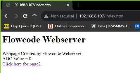

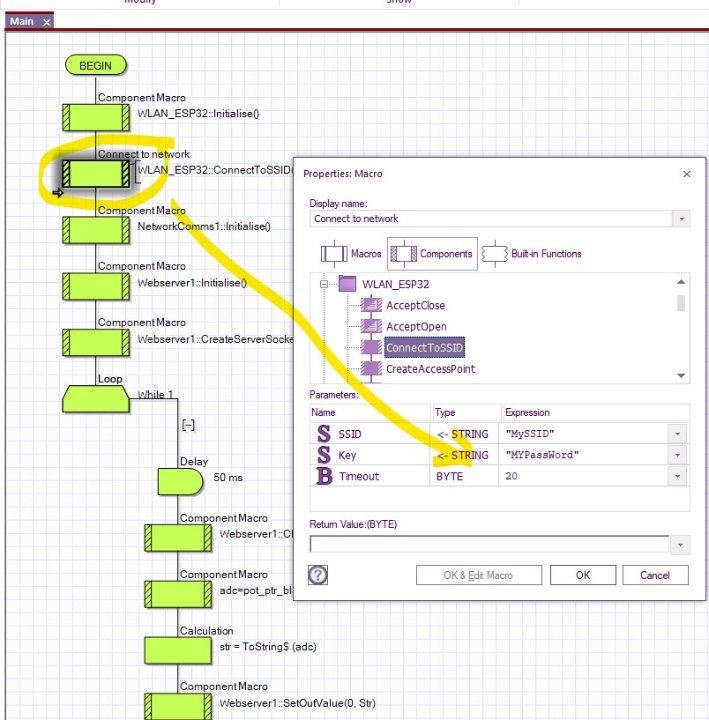

You can try with this prog, it's for TTGo but you can change the Target device
ESP_Webpage_TTGO_SEB TEST.fcfx
(15.76 KiB) Downloaded 890 times
need to change SSID and PW
then compile
wait for the connection to router and look the IP address of you ESP32
then you can open webpage and type the IP address of your esp32
