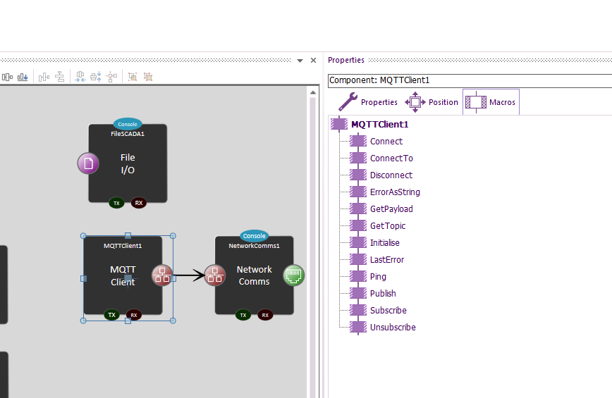

I add the mqtt in my Pc App project but I can't see MQTT::Read function in the MQTT Component of Pc App.
If I understand good, I need of this function to check message update.
Capture d’écran 2025-05-05 002229.png (61.31 KiB) Viewed 6703 times
If I check the MQTT Component of the Wiki, I have not MQTT::Read function.
How to follow the MQTT Comms Pc App Example ?

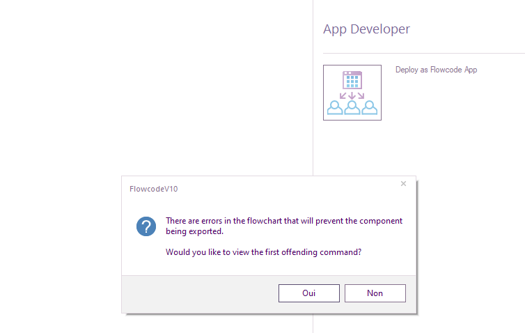

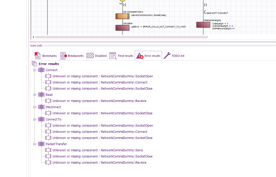

I downloaded the source file of MQTT Component from Wiki to open the MQTT::Read function but I have an error when I want export the MQTT Component about Network Component functions.

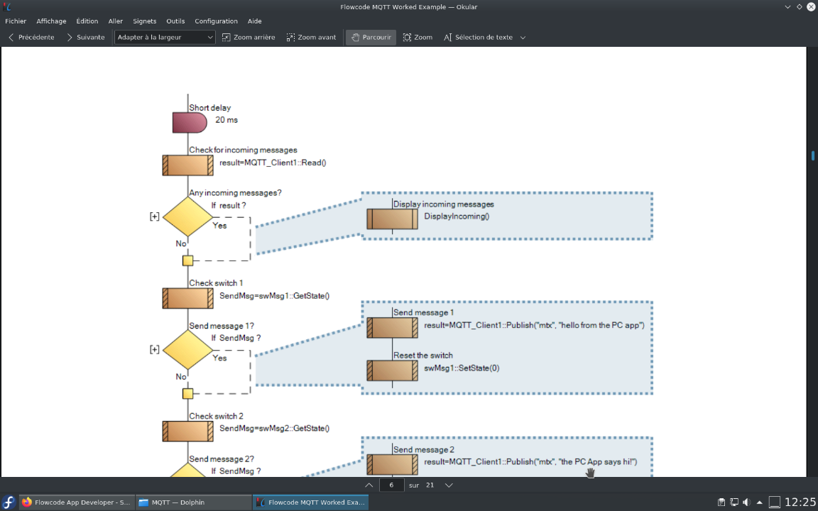

I opened the SCADA_MQTT.fcx file, we must also use MQTT::Read before GetTopic and GetPayload.
