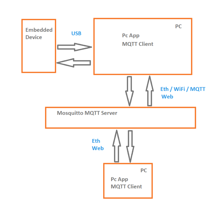

Our projects are like this schematic but in place of Web App, I ask me if we can have also a second Pc App with MQTT client.

I also need simultaneous connections on different devices.
So, many questions before design the web controller App to choice the best way.

As I am sure you apreciate, the speed over the internet is not something we can control. If updates were in any way critical to you (and you decide what is) then some form of redundancy and qualification should be considered.

For MQTT I just sent On / Off as message to a specific Topic. FC client published, another FC client subscribed and acted.
As mentioned, I've not really played with app developer in a while so I would need to go remind myself about it, but I don't think your overall concept is troublesome especially as app developer has a template for MQTT client and therefore must be able to do what you need. It could also "poll" a server too.

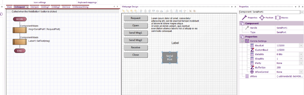

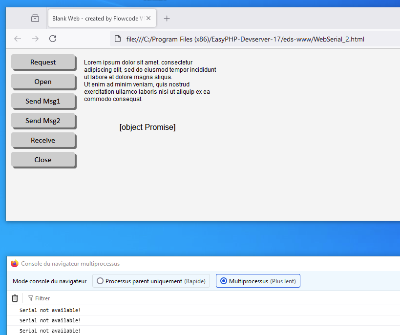

I tried Serial COM Port example Web App the last night, but it don't work. I have error message "Serial not available" in the console. I added Text to see the result of the Request button but I obtain only "object Promise" message. As this component is only a Beta version I don't lost more time with this component.

When I prepared the Web App project to drive our device, I firstly think to use AJAX. But I will try with the FC to drive the device from the local network in a second time. I think win many time with FC. The reason why I don't develop the Web local control in a first time is about the WiFi consummation.

"Serial not available" sounds a bit like an incorrect com port has been selected. Does it give you options?

In fact I don't understand how select the number of the Port Com with this component. If I understand good, the "RequestPort" function select the port number per VID / PID.
I restricted the list to obtain connection only with my VID PID in the Filter properties. But with or without this parameter, I have also the same error. Embedded device is connected and linked on port com 14.

Have you tried other browsers? The Serial API is relatively new and some browsers might not fully support it. When I created that Web Developer Serial component, I did most of my testing on Chrome on a PC. I've not done much with Firefox.
Another issue is there are a few different ways for virtual COM ports to be 'known' by the OS. If the browser is not detecting your serial device, then it might be using a serial driver that is not fully compatible with the Serial API.
