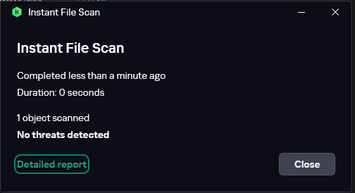

Hi all. attached is a signed version, so Hopefully it's now AV friendly.
I ran another scan since it has been signed.
Kaspersky scan on exe.png (18.52 KiB) Viewed 4854 times
Can you give it a go and let me know how you get on with it please.
