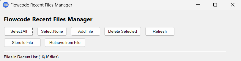

Flowcode v10 Re: how to delete unneeded or old projects?
mnfisher wrote:
Tue Jul 29, 2025 7:18 pm
Sounds neat....
Yes please!
Sure and thank for your interest
In that case I have made improvements that now allow up to 16 entries, can save or load backups, and you can now select any flowcode project and add it to the recent files list.
I have cut off the actual file list in the image for privacy.
Can you let me know how it works for you and any bugs/suggestions etc. are most welcome.
Edit: removed unsigned file and replaced with a signed file here
