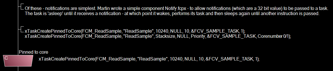

You need the TaskId from xTaskCreatePinnedToCore - to pass to notify..
I think it is the last but one parameter - and you'll need to pass the address of a FC variable..
So if the variable is SaveToSDTask (needs to be a UINT32) - then pass &FCV_SAVETOSDTASK - the 'drag' variable to the C block is good here....
& - gets the address..
If you use Notify to wake the task then it shouldn'tneed a delay....

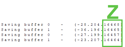

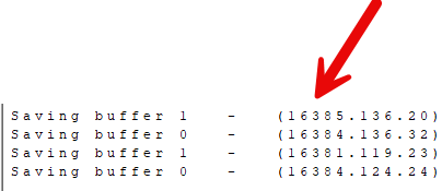

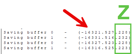

Just tested - and yes. The results look sensible...
Saving buffer 0 - (182,1678,-16281)
Saving buffer 1 - (154,652,-15675)
Saving buffer 0 - (-16348,436,500)
Saving buffer 1 - (-16326,482,950)
Saving buffer 0 - (-34,16344,-922)
Saving buffer 1 - (2,16330,-965)
With the board 'aligned' in each of the 3 planes. I set the delay between samples to 10ms - to allow a more sedate update rate...

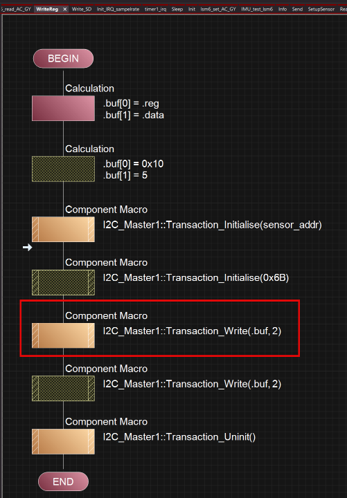

My program give a watchdog error if I write to I2C even in at loop an begin

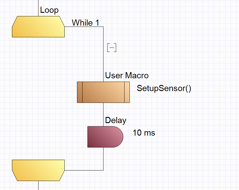

Not entirely sure why the wdt is getting fired - but in main() - you have a loop
Oops - sorry a bit larger than expected!
Which doesn't exit - is this intended? It has a delay - so wouldn't expect the wdt issue though (although the program won't progress?)
