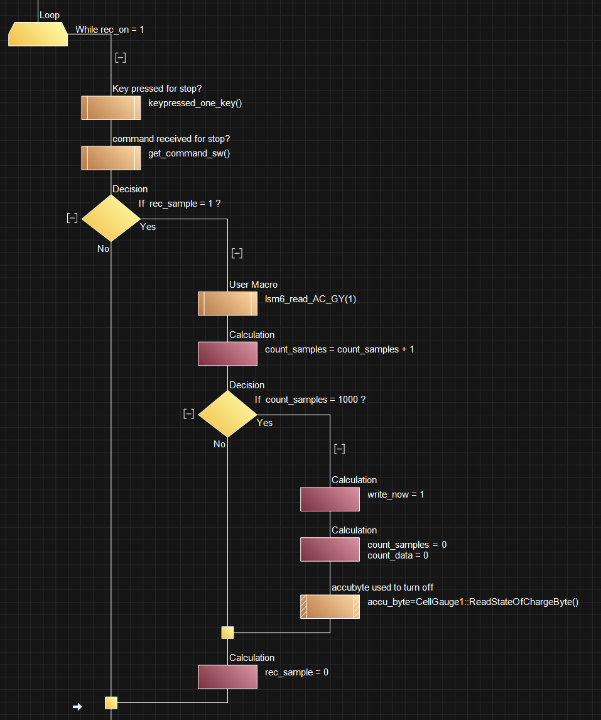

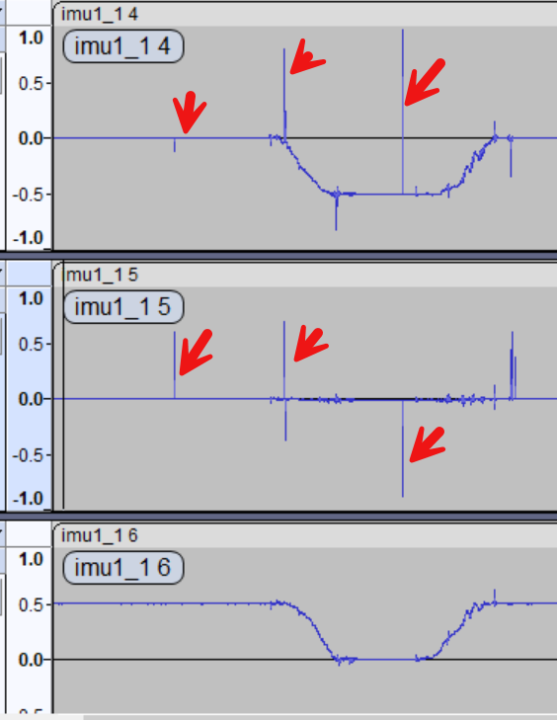

But there are a few errors in the data. I will call these needles. I have sampled the LSM6 in IRQ with the STM32 and there the values are perfect (but I can't save to the Sd-card) One idea is to read the LSM6 more regularly like the STM32.
Now I set a variable in the IRQ to read data. But depending on the position in the main(rec macro) it goes faster or slower until the macro is called, irregular reading is maybe not so good.
Accelero data x,y,z with a movement:

The spikes are odd... Do they give incorrect data - or are they so short as to be ignored?

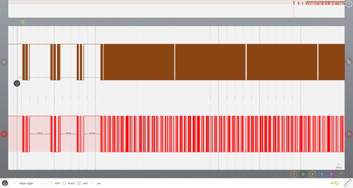

A shot showing a multiple read - as can be seen there is a 'gap' between writing the address to read - first is a read of the status registers (2 bytes) then send of address 0x3e - then multiple read. The multiple read seems to be consistent speed - As can be seen - the read gets 'blocks' of data with small delays at intervals (7uS - but I didn't measure how much data)
The 'read' would be best pulled to a separate task - and ideally use an interrupt when the FIFO buffer has reached a certain level. However, the delay / ODR can be adjusted to allow a maximal read size too...
