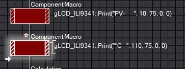

I have not been working on this project for some time but now I have a little time and would like to sort out the degree symbol. As you can see it in the previous post that is giving me 4 lines instead of the degree symbol. I am using the Default 8 (legacy font) how would I be able to sort this out?

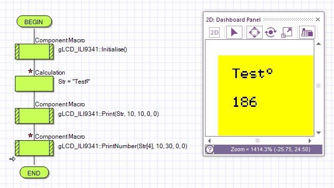

I'm looking for you now and the default font should be printing out the degree character for any of the following ASCII character values 128, 167, 248.
Can you check what value you're sending for the degree symbol. If you know which character in the string it is then you can do something like PrintNumber( string[charidx] ) to know for sure what the decimal ASCII value is.

What I'm doing is typing Alt 167 ยบ which is the degrees it used to work then I did a component update and it stopped

Alt 167 should give you the decimal number 167 but I found that actually this is not guarenteed. It's worth seeing what number the compiled C prints out using the code I suggested as that might give me a pointer to investigate further.

Im not sure what you need me to do PrintNumber( string[charidx] ) I've tried the print number but all that dose is print the 167 and not the character

Ok so it is confirmed it's 167 being used. Hmm let me look again.

What happens is very strange.
If you type alt 167 then the number ends up as 186 when you print it out using PrintNumber
alt 248 ends up as 176
Anyway I've now supported both of these numbers too, maybe something to do with ASCII to utf8 conversion?
This is now working in simulation
Please can you have a go and let us know how you get on. Latest versiion is now on the update system.
