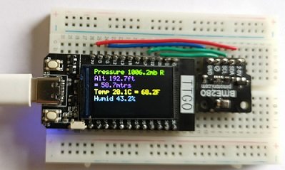

There have been some issues with this.
If it does not work for you, I will add a simple sample.
