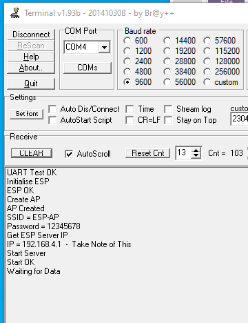

When the Rx boots you should see the following in "Terminal" or Excel DataStreamer.
Once the Tx boots you will see a few lines regarding connection, before your Data starts to appear.

When you test can you do the following for the Rx (forget about Tx, don't even power it).
Set up a Terminal program to monitor PIC UART-2 Tx pin (PIC Tx to USB-serial adapter Rx). Remember to check Chip Tx/Rx pins match your setup as in the last iteration UART-2 pins moved from Port D to B. Check baud is 9600.
Boot / cycle power on Rx circuit.
You should see something similar to the screenshot I provided in an earlier post. If not can you provide a screenshot of what you do see?
If you get to "Waiting for Data" then boot the Tx (again check pinouts etc match).
On the Rx you should see a few lines relating to connection, then data should start. If not can you send a screenshot of what you do see then we can check Tx.

with Terminal, I get diagnostics when I start RX (serialusb1)...DATA when start TX (serialusb2)...everything is ok.
in DataStreamer with same procedure as above I have no data (datastreamer1)...
