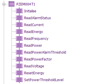

I'm creating a PZEM-004T component to take all the hard work out of getting the PZEM-004T to work.
These are all the working functions so far:
PZEM-004T component.png (235.01 KiB) Viewed 6155 times
It's work in progress for the other functions.
Hopefully, it will be ready soon.
The component is for Flowcode v10 which of course is free.
The reset energy and the read voltage, current frequency, power, power factor & energy are working.
If you want the component without the alarm functions then I will post it at your request.
When all the functions are working, then it will be available via the component database.
Colin if you want a reset function then what about trying Flowcode v10 as all the components are free to use and there are some great new features.
I have placed the PZEM-004T in Misc Circuit so its also available within App Developer.

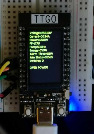

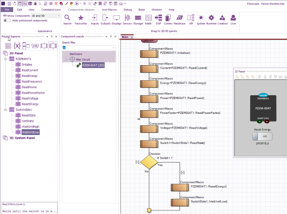

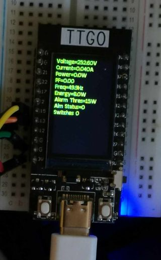

Here are all the enabled functions:
PZEM-004T component2.png (16.16 KiB) Viewed 6125 times
For the component to work there is no requirement for a variable within the return value.
Can you please let me know how you get on with the component?
It will be added to the update system next week.

The PZEM-004T voltage is accurate to 0.5%, so you are not seeing a PZEM-004T that is out of tolerance.
My mains voltage is too high at times.
