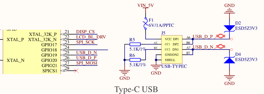

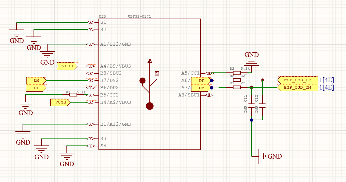

I use the GPIO18 and GPIO19 like the schema for UART/USB
But as soon as I switch on the Uart in FC10 and flash I can not connect anymore the ESP to the computer,
there is no com port anymore also not in the terminalprogram.
For the next flash I need to press reset and boot first

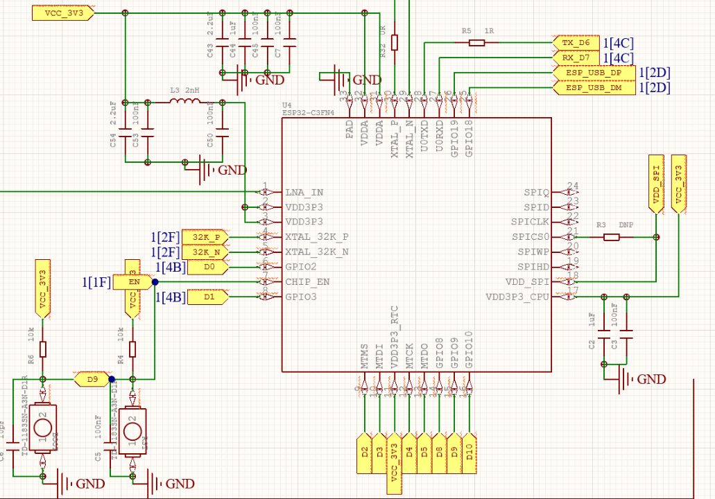

It looks like on that device there may not be a UART to USB bridge IC and so they expect you to use the USB peripheral as the comms. We don't currently support the USB on the ESP32 devices but I could add it to the list to investigate if that would help.

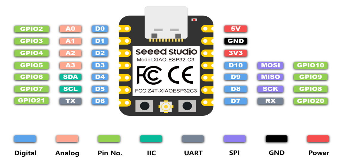

UART to USB bridge IC are often relatively large so that they are missing in the very small board.

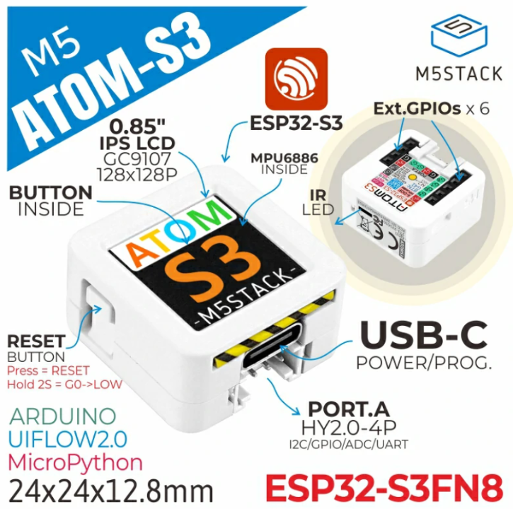

I can't use USB with Atom S3 with display either.
The Pin's go direct from ESP32 to USB pin
A USB component would be useful for transferring data.

Did you get the S3 to work?
Just tested with a C3 and using the JTAG / USB link and printf("string"); works well with this variant too! So you could output to USB and 'catch' the data in App Developer here too?

I think only the S3 has this option, a built-in UART to USB bridge.
This is not possible with the C3. I should also be able to reach 921600 baud and send and receive integer arrays to the AppDeveloper.
