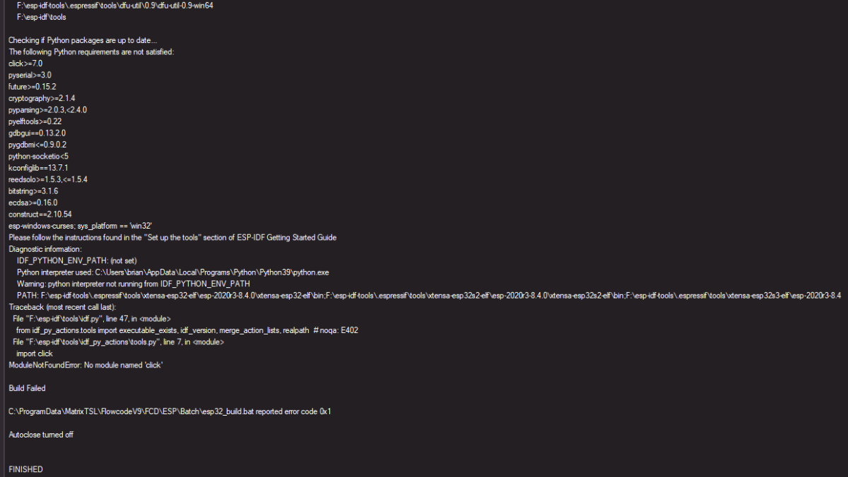

Hi guys I'm getting this error while trying to compile to the esp32 module. I have the Python 3.7 & 3.9 installed on my machine i have installed the esp-idf-tools-setup-offline-2.10 and set the global settings for the esp32 to the folder the esp-idf is in but cannot get this to compile
ESP32 .png (181.58 KiB) Viewed 15753 times
Not sure where to go from here to get it working

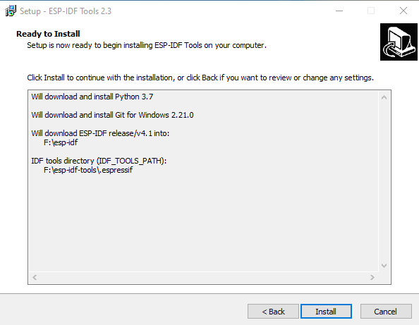

Thanks for the reply I have followed the flowcode esp32 tool chain installation many times with no luck the one thing i have noticed is that when you get ready to install section my files are loaded in different directory
My installation

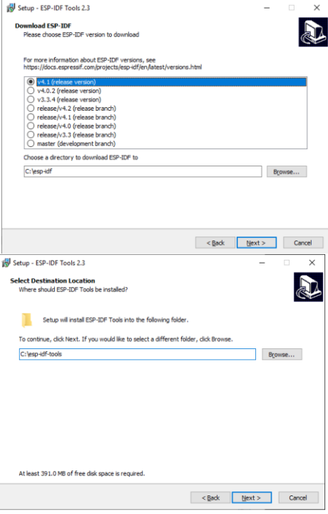

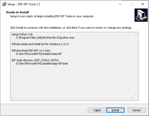

Before installing, if deleted the folders you get the option to enter the path on the next install:
Setting up Paths.png (107.84 KiB) Viewed 15708 times

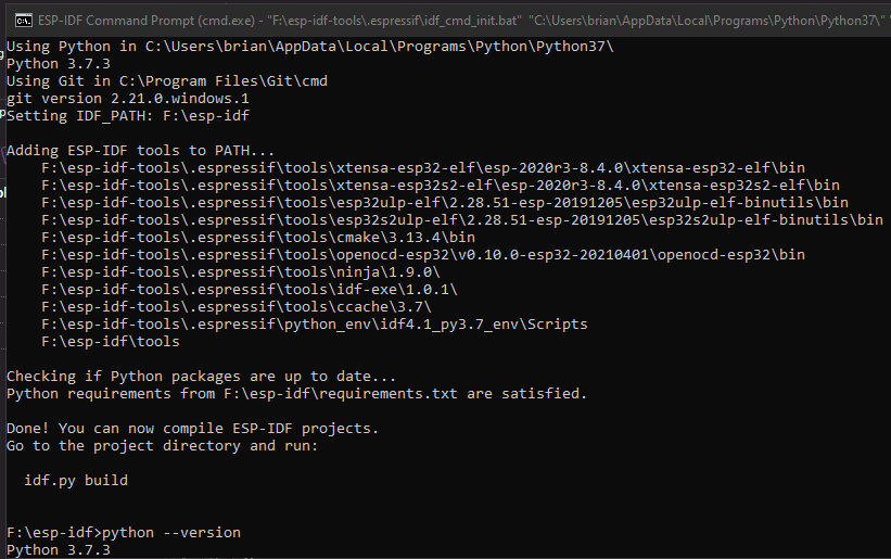

Could you run the "ESP-IDF Command Prompt" (not standard Cmd Prompt)
this should be on your desktop.
See if any errors are reported.
Then type
python --version
and see if Python runs and reports same version.
Re: ESP32 Compiling error
Posted: Mon Sep 06, 2021 11:55 am
by jollybv
I have done that and everything is right
python version.png (48.55 KiB) Viewed 15693 times
I'm really at a Los as I have done everything according to the installation instructions.

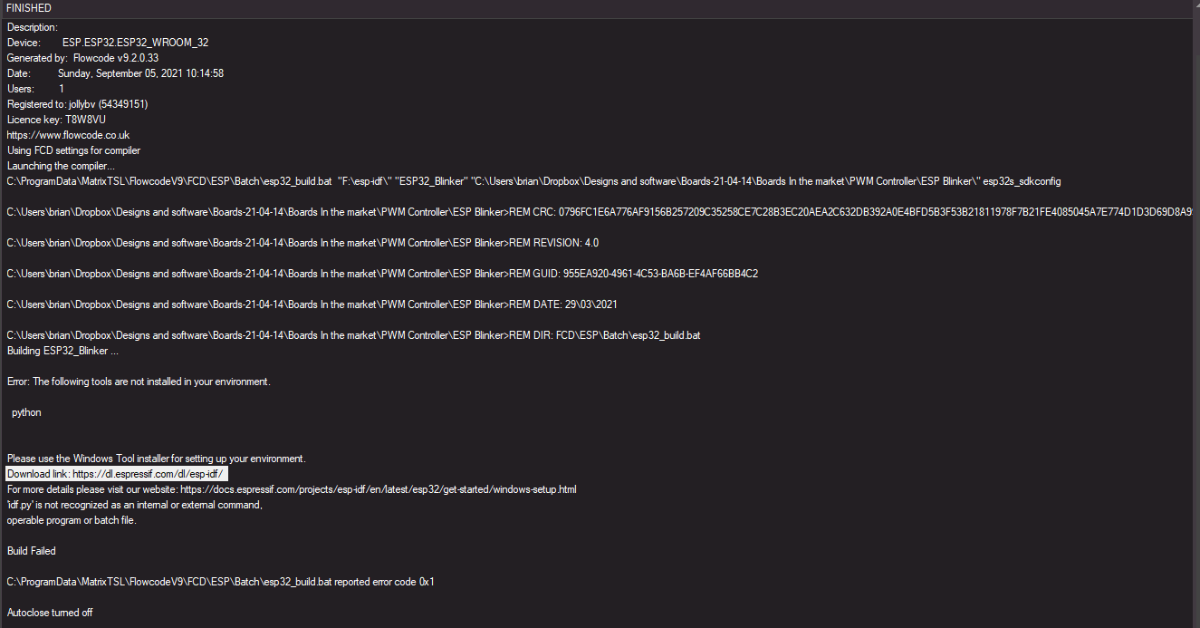

Can you now re-try your project and post the msg.txt file?
Posted: Mon Sep 06, 2021 12:20 pm
by jollybv

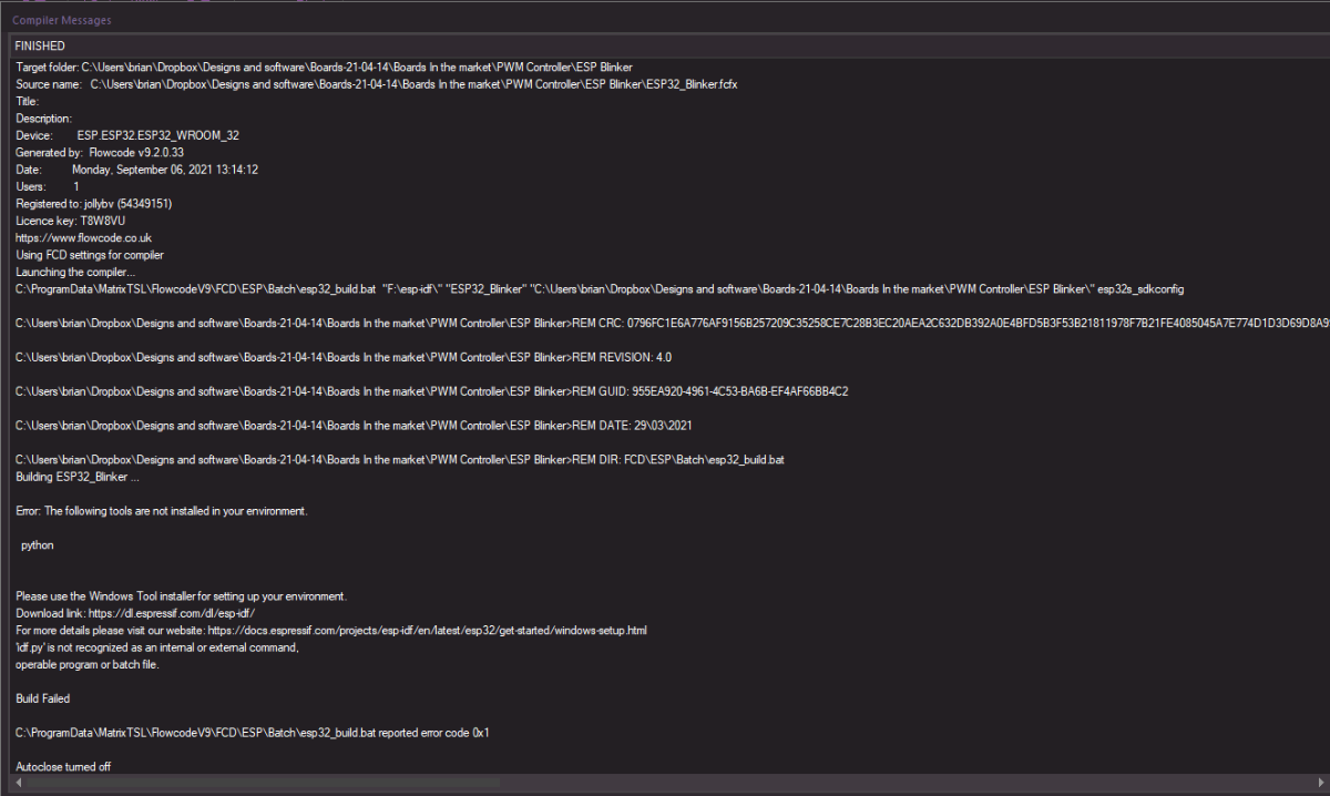

Its still the same telling me that i don't have python installed
compiler message.png (238.38 KiB) Viewed 15691 times
ESP32_Blinker.msg.txt
(2.53 KiB) Downloaded 872 times
Posted: Mon Sep 06, 2021 12:35 pm
by BenR
Tha's very strange, is Python installed on a different hard drive? Might be worth checking that the Python executable is on your windows path just in case this is causing problems.
https://www.architectryan.com/2018/03/1 ... indows-10/

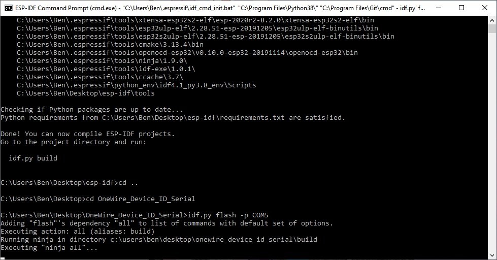

You can also maybe try launching the compilation from the ESP-IDF Command Prompt and see if this works or reports the same error. Just navigate to your project directory and then into the build folder created by Flowcode then type in the following command to compile and program. Change COM5 for your COM port.
idf.py flash -p COM5
As a last resort maybe try re-installing the idf but using the Python it packages with it. This includes things ike PySerial and other none standard libraries so maybe will include anything your currently potentially missing.
