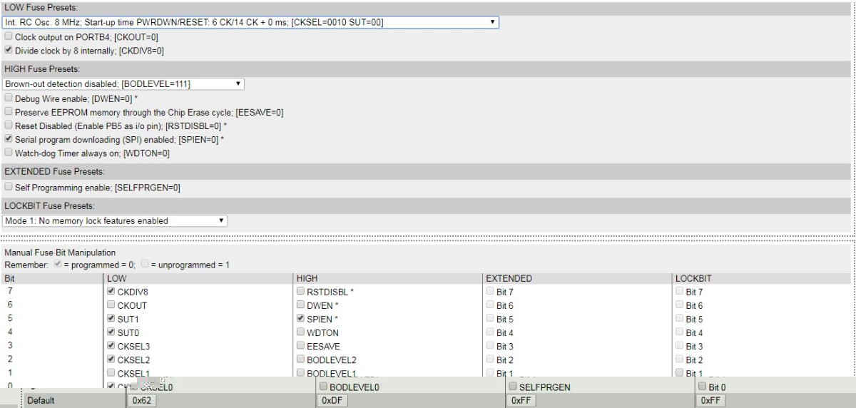

I use the eXtreme burner recorder and to configure the fuses I count with the help of the AVR FUSES calculator, current fuses I used, and the fuses I send separately.
http://eleccelerator.com/fusecalc/fusec ... p=attiny85

Re: ATTINY85 + dht22
Aha now we are getting somewhere.
You are using the 8MHz internal clock which is good but you also have the divide clock by 8 checkbox ticked which will bring you down to 1MHz. Untick this and you should be good to go at 8MHz.
Hello Benj
I am very grateful for your help, when I disabled the CKDIV8 fuse, it returned to work as expected, but before that I still found a fault of mine (not forgiven by myself), I had programmed samplesensor equal to 1 for success, and not equal to 0, as specified "Returns 0 for success, 1 for no communication".
Once again, without your kind help, I would not have reached the end of my project.
